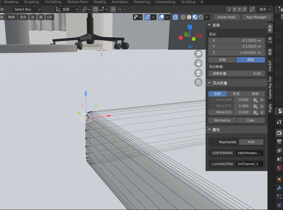

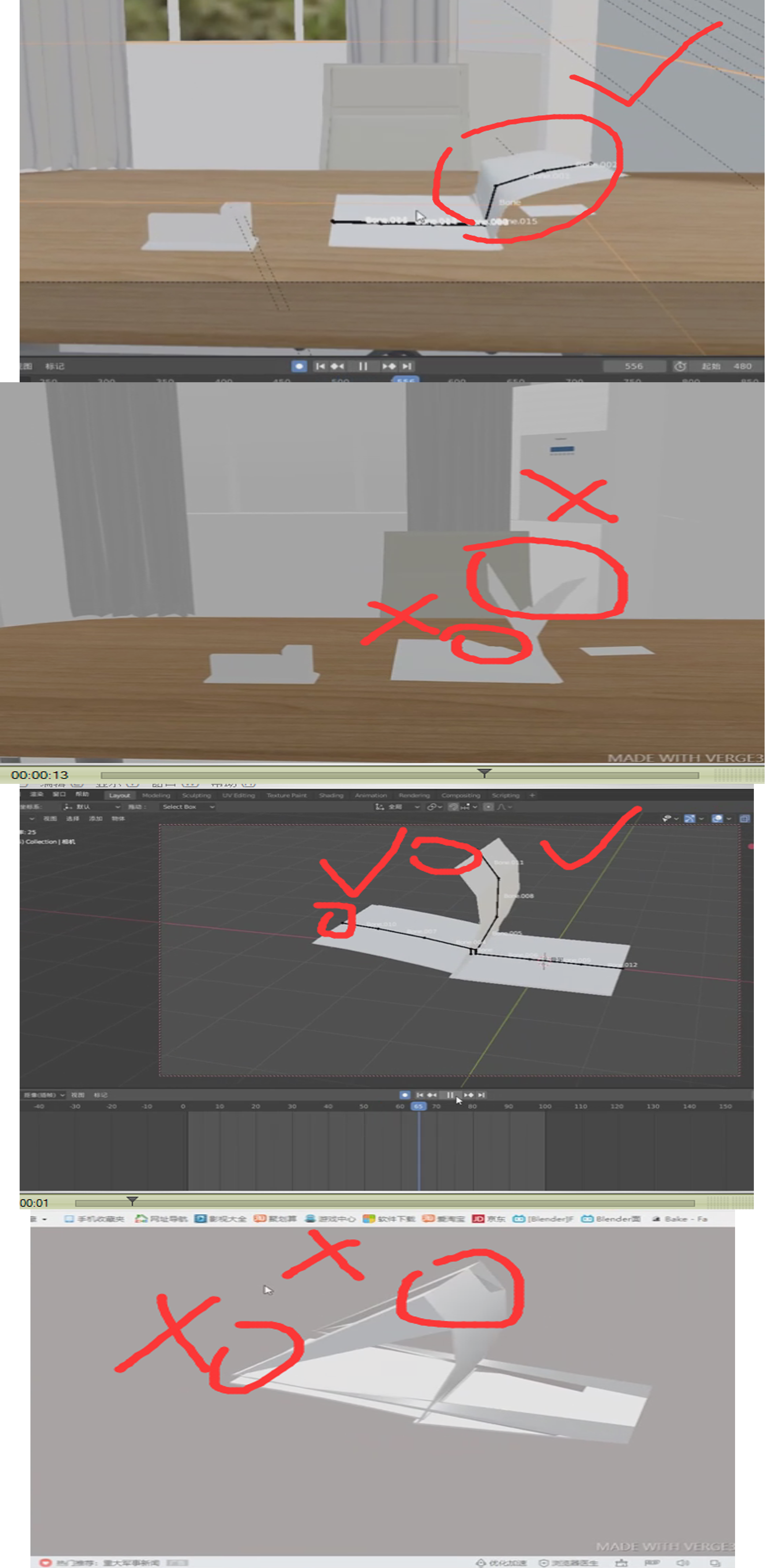

    I found two problems. After keyframe animation in blender, I found that there were problems playing in the software and in the web page. It was obvious that there were broken faces and incorrect animations in the web page

    Check that each vertex has max 5 bone weights, better less. If it hase more clean all 0 weight, it should help.

    I do it but its problems
    I selected all the point weights and then displayed them as the video operation, but the results still did not change. I do not know how to solve this problem. Thank you for your help

    Thank you very much, I have solved it. Since we have encrypted files here, I was worrying about how to give you the files so that you can check the errors in my files. I followed your suggestion again, and this time each page gave him the least weight, so a miracle was born. The previous problem was that I only chose the cover of the book without reducing the weight of the other pages, which led to this problem.. Anyway, thanks for getting back to me, and good luck.
