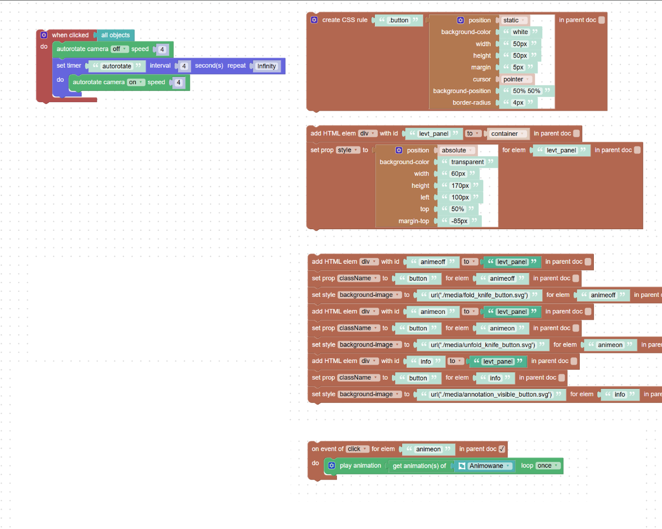

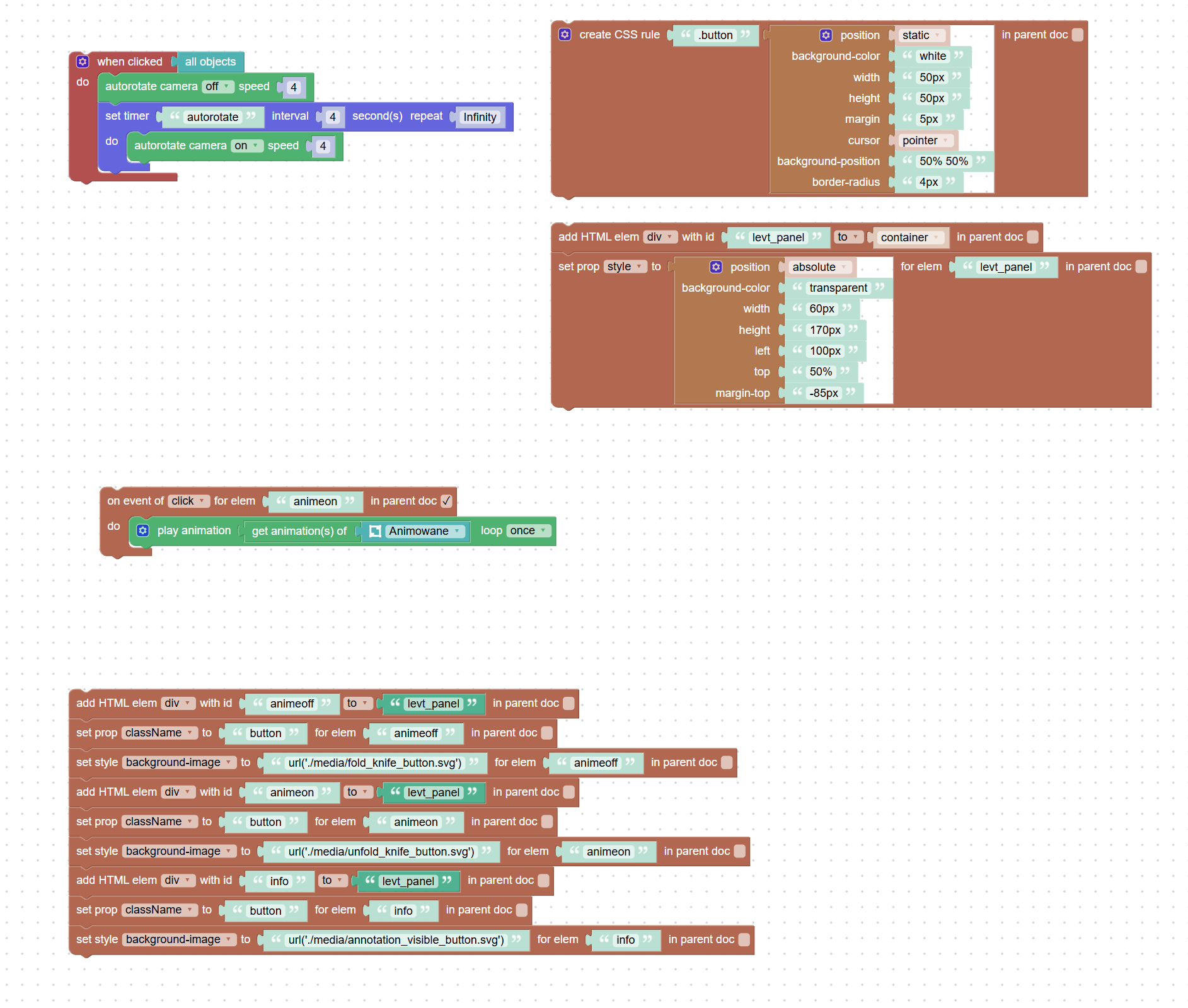

    I was following a tutorial on YouTube and created a button using puzzles, but it doesn’t trigger the animation. The animation works without the button. Did I forget something?

    Puzzles have an order of execution. Top down left right I believe.
    Anyway…your puzzles by themselves are correct.
    Move your on Event of click below all your other puzzles and it should work.

    Thank you, it works now. I wasn’t aware that the order of assembling the puzzle matters.
