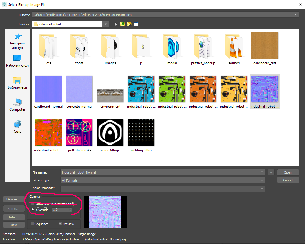

    During a test, I realized that my 3D object presents areas with hard lines ( see image in attachment ). After observation I realize that the problem comes from the normal map. I tested the same 3Dmodel and textures in Unity and this work well. Have you ever encountered this problem before ?

    When you connect a normal map to a material you need to set Override set to 1 in open image window settings.
    #26793
    it works! :good:
    Thank you :)
