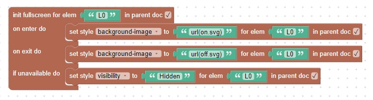

    Hi, I want to set the automatic full screen and horizontal view only if on a mobile device, can anyone help me? can this be done directly from the puzzle?
    #60190
    cralex75
    I solved part of the problem using “init fullscreen”
    I can’t create a command to activate Screen Orientation
