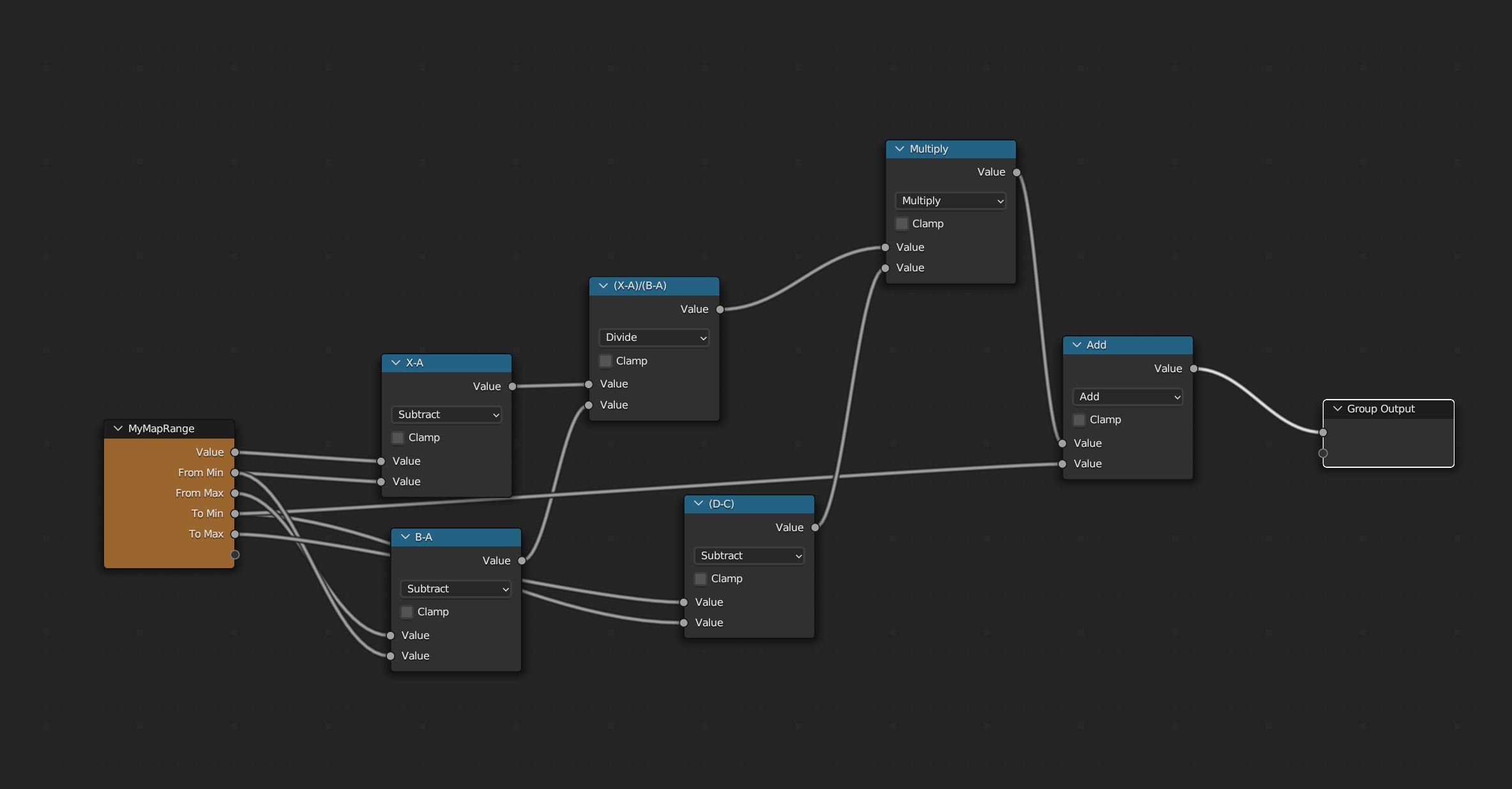

    Work around…. create your own Map Range node .

    Here is one that has the Map Range node replaced.
    It should work regardless of the device you are on.
    https://v3d.net/tm6. – working desktop (win and mac) and mobile
    https://v3d.net/tm1 – not working on Windows desktop or mobile – works on Mac OS
