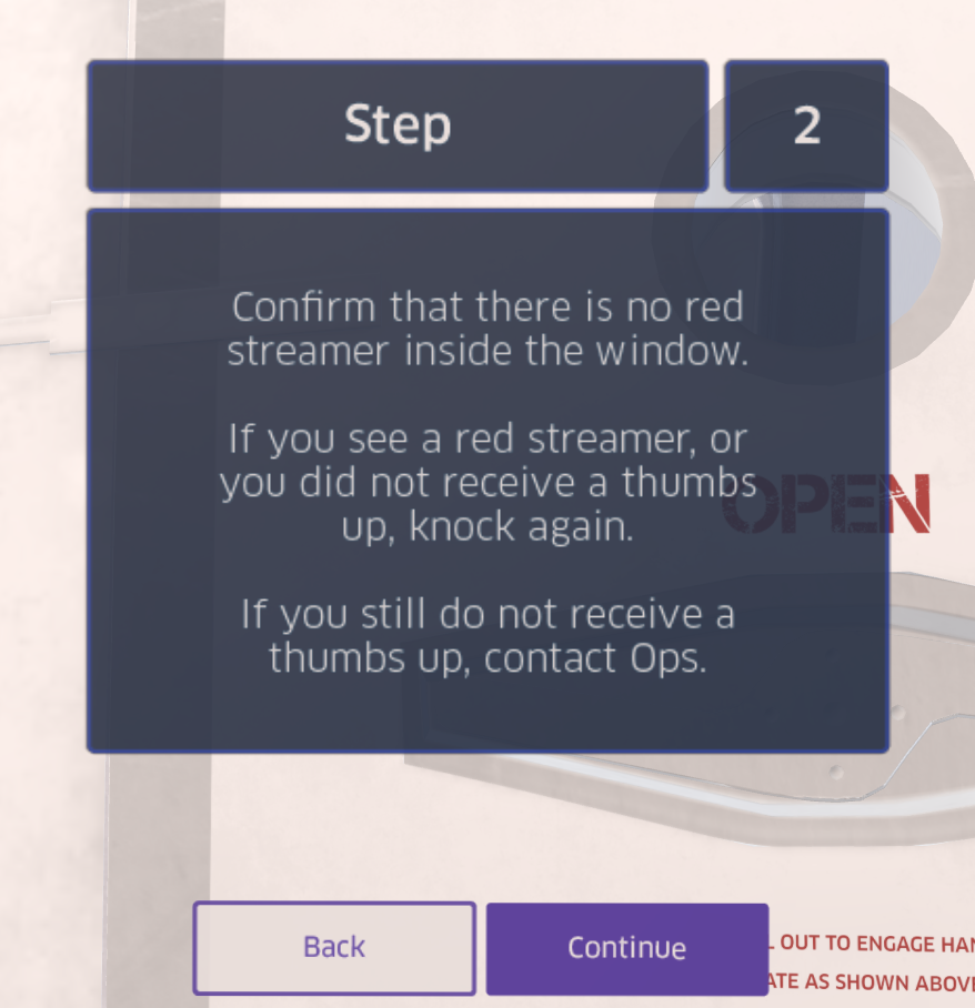

    Is it possible to make a user interface without using HTML, and make it responsive? or if not “responsive” maybe is it possible to check if it’s a mobile phone and if a mobile phone, use these puzzles instead? I see a “native screen scale” puzzle, so it makes me think it might be possible.
    I’ve created a UI with Blender that’s parented to the camera, so as the camera moves the UI moves with it, and it works fine, except that I am basically guessing where the buttons will be on mobile phone (and desktop as well, really).
    Any ideas?
