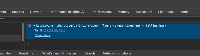

    This is what is reported in the console..
    #72104
    see injected.js (it’s not supposed to run at all) :unsure: it’s your Chrome issue. as a variant, one of the Chrome’s addons is a culprit (see Sources tab -> Content scripts in Dev tools).
    #72105
    Yup…found it….thank you. Chrome addon culprit in deed.
