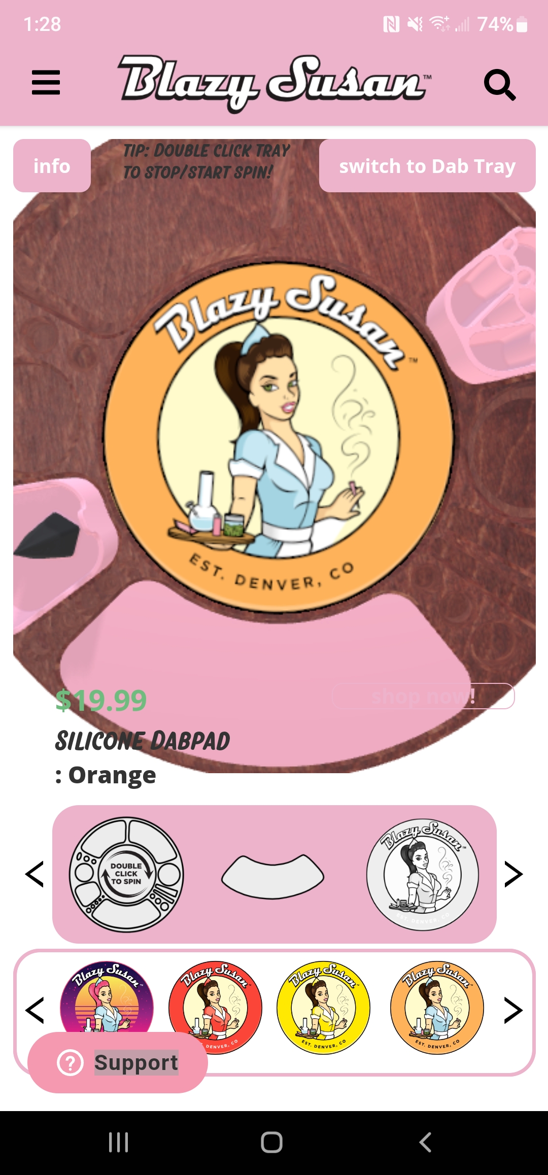

    Blazy Susan
    where do I put these blocks? I tried just making them and updating the main file but still looks the same… see pic below
