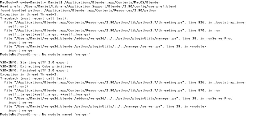

    Hello there, im having the same problem than "Holt_interactive" : App manager doesnt work. I have download the zip file to replace the server.py file and try to run blender from the terminal and blender opens but the terminal shows the attached view. I hope you can help me, thanks :)
    #35385
    danielops
    Never mind , i delete and rename file hosts and works !!!
