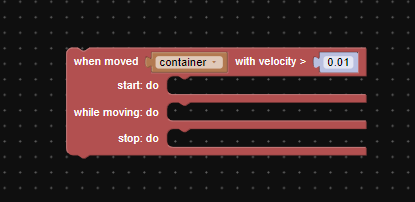

    I did a few tests and the ‘load scene’ puzzle will not work if there is a ‘when moved’ puzzle active on the canvas. The ‘append scene’ puzzle will work but not the ‘load scene’ puzzle.
    I’m pretty certain this is a bug. It does the same thing even on the ‘Load_Unload’ demo if you drop a ‘when moved’ puzzle on the canvas. The ‘add scene’ button still works but not the replace button, since it uses the ‘load scene’ puzzle.

    The quickest way to replicate the issue is to open the Load Unload demo app and add a ‘when moved’ puzzle to the canvas (Puzzle editor), like usual.
    When you launch the demo, tap the blue ‘Replace Scene’ button. You’ll see that it does not load the .glTF scene and locks the camera.

    You mean this way? THis is just a wrong way to use WHen Moved puzzle and it cause critical error, that’s way nothing works. This puzzle must be used only with objects.

    It does the exact same problem even when used with objects.
    Please try it with the Load Unload demo and then try to press blue ‘Replace Scene’ button. It freezes the camera and stops working.

    Thanks, we were able to reproduce the issue. The fix will be available in the upcoming Verge3D pre-release.
