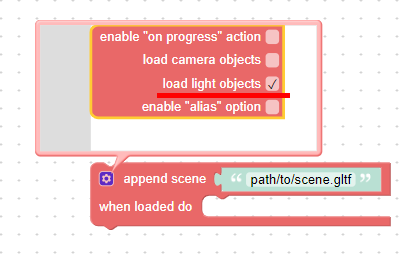

    Does it mean in case of an “append-scene” puzzle node, lights are not included or directionalLight is not supported by verge3D ?
    #27399
    Oh, I see what the problem was. They are not loaded by default, but you can enable it in the puzzle itself:
