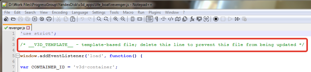

    Is there posible to change the way upgrades are made, so we don’t lose our personal functions ?
    #65840

    #65841
    NaxosCG
    Also, this will not prevent the v3D app to be up to date ?
    #65844
    v3d.js will be updated in any case, html/css/js – depending on that line.
