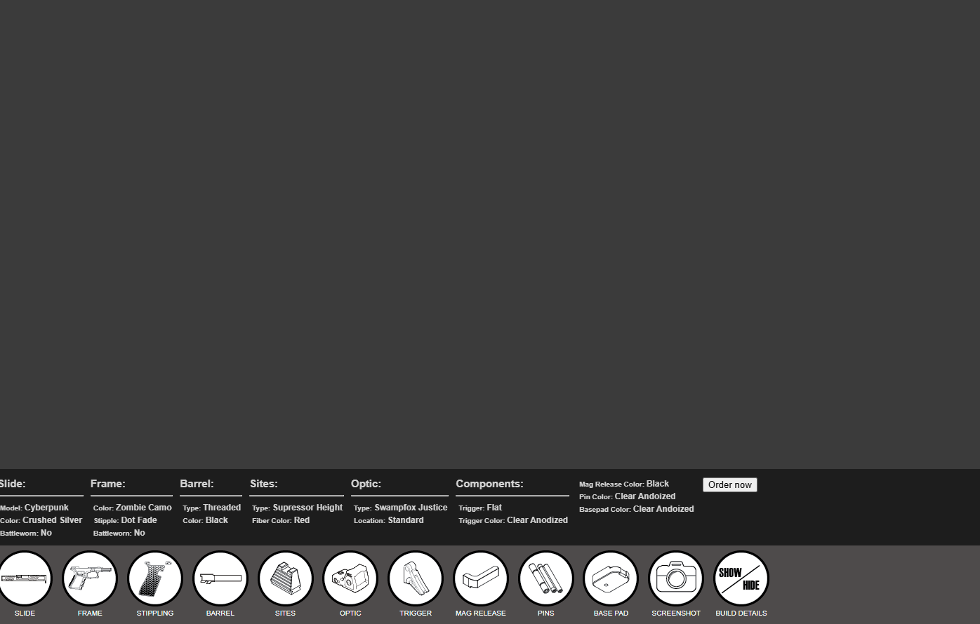

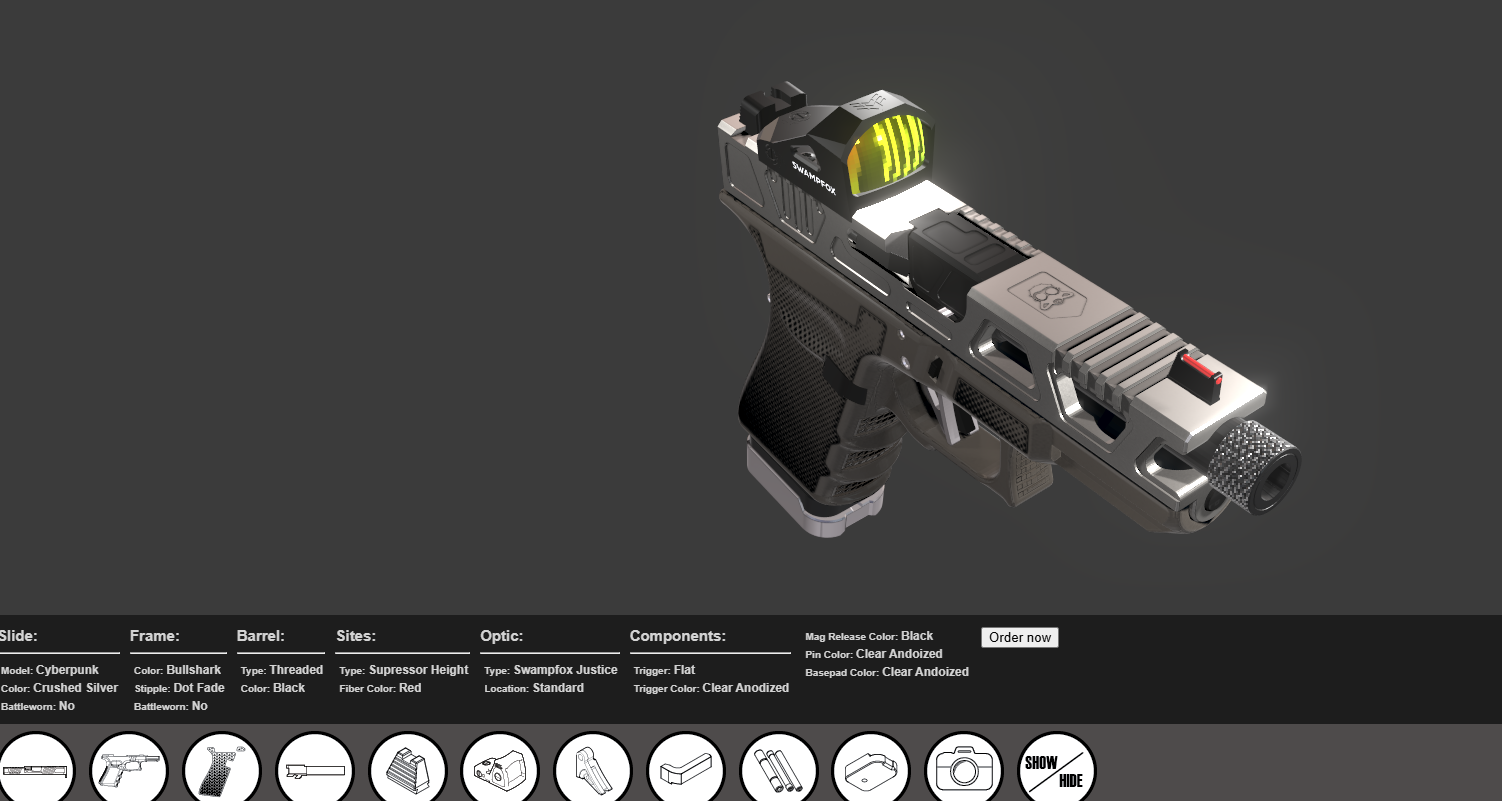

    We are having an issue where we updated blender and verge 3d and now when our scene only shows a grey screen when output, the model doesn’t come into view with any amount of zoom or orientation, not sure if anyone can help with why that is.
    I have attached images of the issue, i dont recall the previous version of verge we had, but we had blender 3.2.

    Hi dmon86,
    There were a lot of changes both in Blender and Verge3D since then. Be sure to update the app itself, and to reexport the scenes and resave the Puzzles after updating. See also this migration guide.
