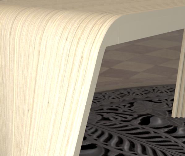

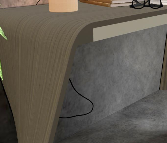

    Could you guys help me to solve one more problem…?…
    I can not re-assign the original material after assigned material at a mesh…
    the original material is a bake texture, without bsdf shader and the one that I can’t re-assign is a bsdf shader with some nodes also with a notmal map.
    I don’t know what’s happening here and what I did wrong………Please give me a hand………….

    Are you having issue re-assigning in your 3D program or are you having issues assigning materials in Verge3d?
    I am guess its Verge3d. As kdv has stated if you are trying to change a material in Verge3D on an object that has multiple materials you can only change the first material.
    If you have material A assigned to a mesh and you change it to material B in Verge3D but cant change it back to material A….try this:
