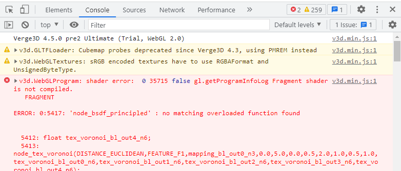

    Both. For now they are not fully compatible yet.
    When encountered some problem, first of all see the console log…
