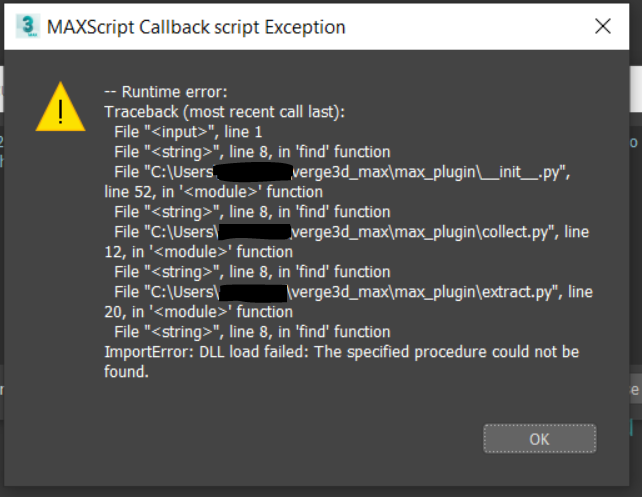

    Hello Verge3D-Team,
    I just installed a trial version of Verge3D (3.6.1) to test the tool for our needs. unfortunately there is an error message saying ” … ImportError: DLL load failed: The specified procedure could not be found.” (see the picture) Do you know something about this? (3ds Max Version 2022)
    Thank you in advance
    mistzigl
    #40595
    the support for 3ds Max 2022 is only available starting with version 3.7 which is currently in dev preview stage. Anyway, it is quite stable for use. You can download it from the same page https://www.soft8soft.com/get-verge3d/
    #40609
    mistzigl
    Hi Yuri,
    thanks a lot! I messed up the whole day yesterday, because i thought its something wrong on my computer^^ now it works!
