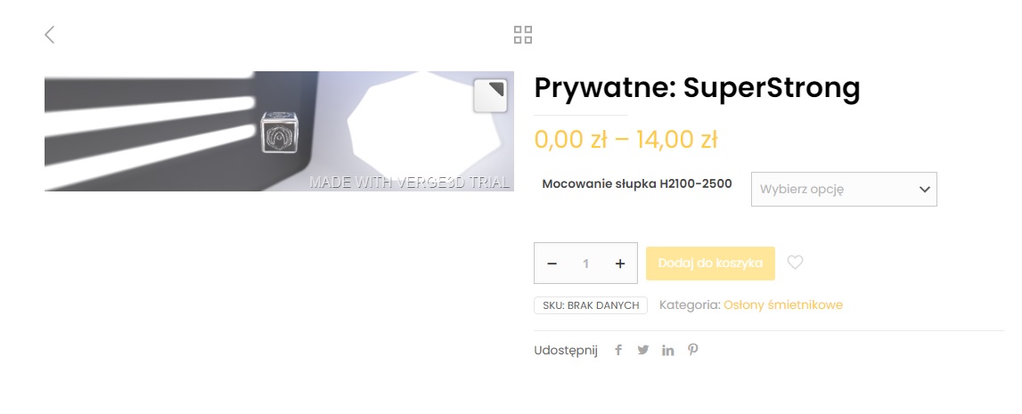

    Hello. I have the problem shown in the attachment. Regardless of product template or iframe configurations, the product looks the same. I used the standard scene to be sure that the problem is not made by me during building UI. What could be the reason ?

    Try to play around with the iframe settings. For example, to get 100% of width and height for iframe, I use this code:
    <iframe src="" style="width: 100%; height: 100%; position: absolute; overflow: hidden;">
    #58996
    .html-embed {
      position: fixed; <-- or absolute
      width: 100%;
      height: 100%;
    #59067
    daim124
    Thanks. I was doing that since the beginning. All I had to do was use !important ;)
