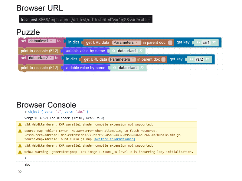

    #42455
    This is my solution so far. I can seperate the values using the dictionary and then go on using them individually for setting up the configuration of the scene.
