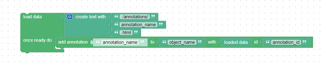

    #25211
    You can create your annotation by separate html elements and them load then into the annotation dynamicaly. Like this:
    #25225
    jaspixel
    Thanks so much Mikhail. I would have spent a month working that solution out :wacko:
