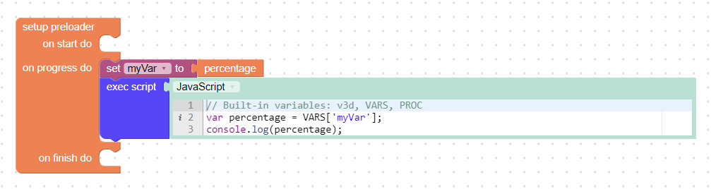

    I need to use the loading percentage to control the stroke-dasharray and stroke-dashoffset of some svg paths as a pre-loader, both of these attributes are not supported in the puzzles and I can retrieve only the first element matching my selection with the query selector puzzle, I need to do that via scripting but I had no luck calling that percentage

    You can use a variable to assign the percentage value to. And then in “exec script” it should be available from the built-in VARS object:
