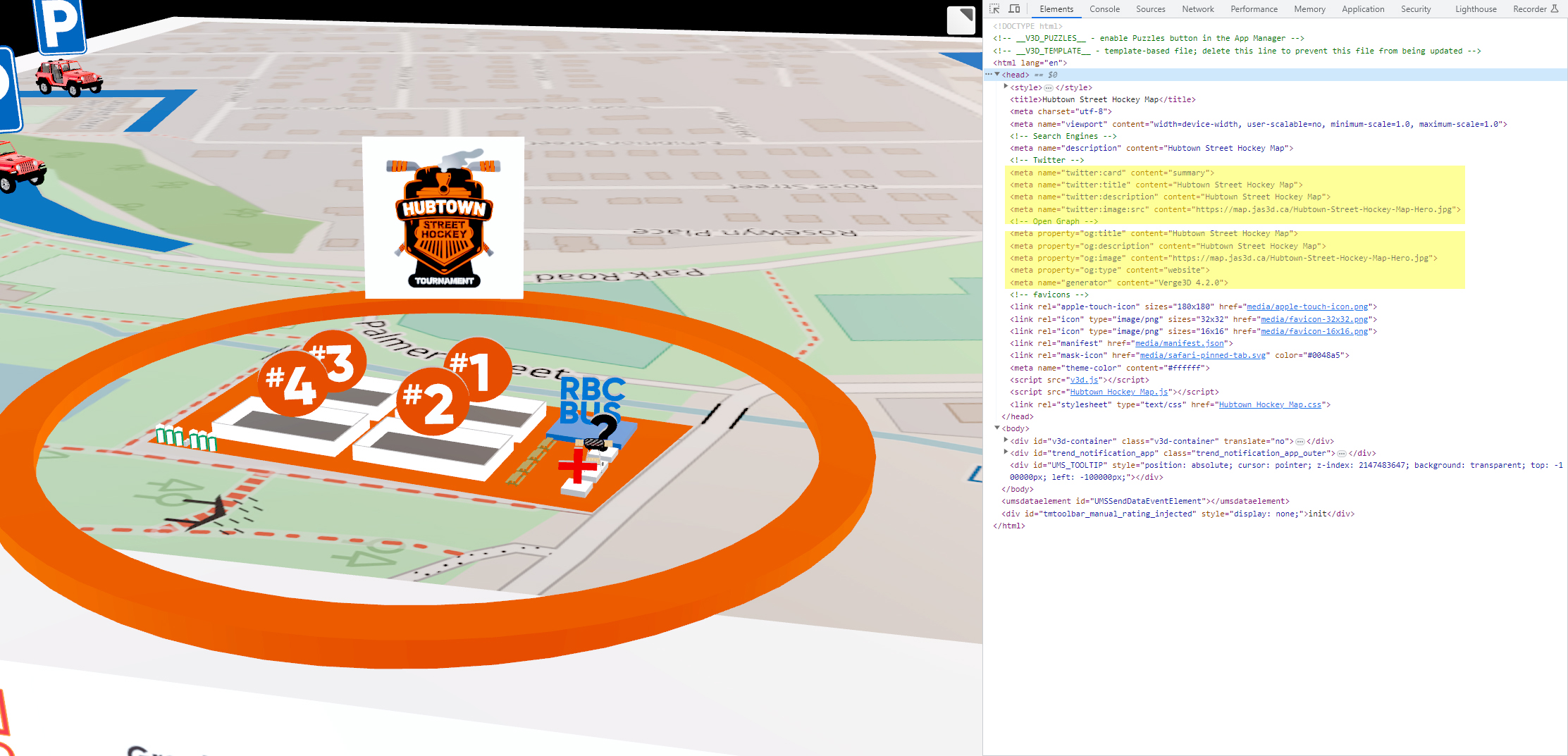

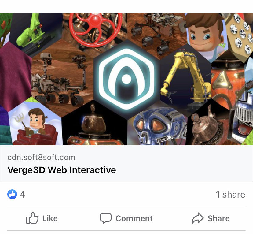

    Hi, I;ve created a 3D Map that I want to post to social media, but when I do the preview shows soft8soft branding and text. I want to show my map and custom title and description text.
    Please see the attachment, “image0.png”, it show what I get when I post, it shows soft8soft branding
    Please see the attachment, “Edits.jpg”. Highlighted in yellow, you can see my edits I created to the head section of the html file. Am I not doing the customization in the correct area?
    Please let me know how to force the post to show my branding and custom information.
    Thank you!

    You will want to host your image on your website and then make changes to your index.html by adding the associated OpenGraph – meta og tags for the various platforms

    THank you Xeon, that did the trick. Your website looks great BTW
