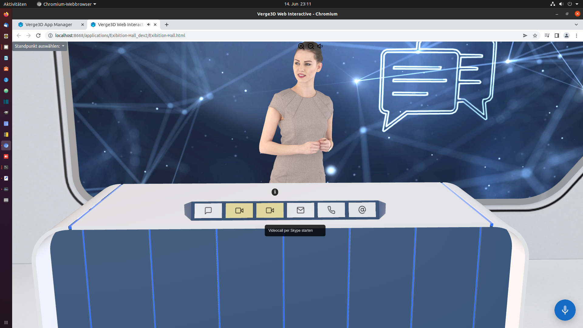

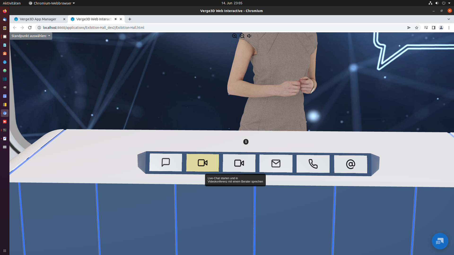

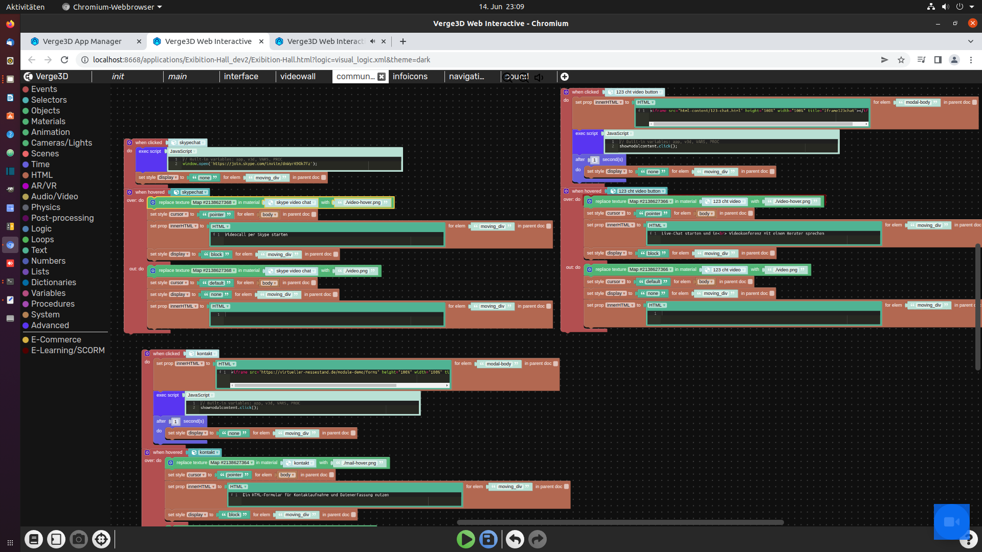

    I had a working hover-effect on buttons (texture change on 3D-objects: skypechat and 123 cht video button) in Version 3.9.1. You can see it in the screenshots.

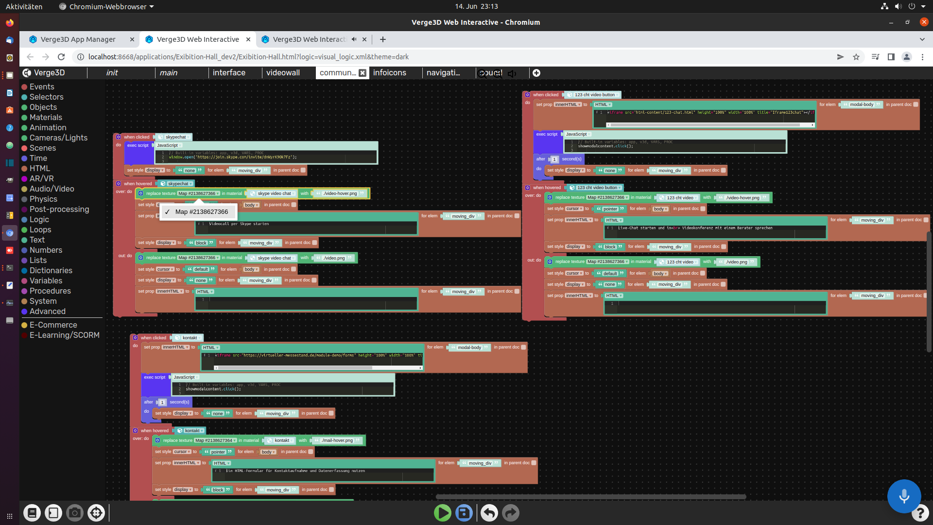

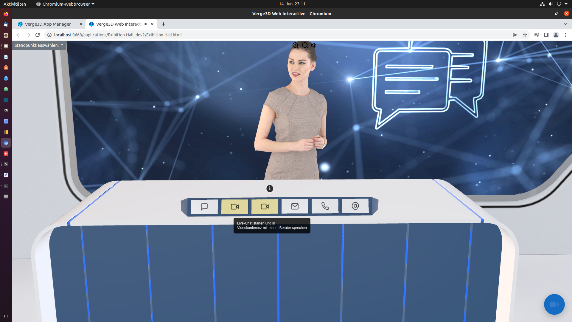

    After updating the app to 4.0, the two buttons now share the same Map# and so, both buttons get the hover state once the mouse is hovering any of them. The Map# in the puzzle was red after update and had to be selected again from the drop down. Now the both buttons share the same Map#.
    The gltf has not been touched, only the app has been updated.

    Pascal
    Here you can see the hover effect worked in version 3.9.1
