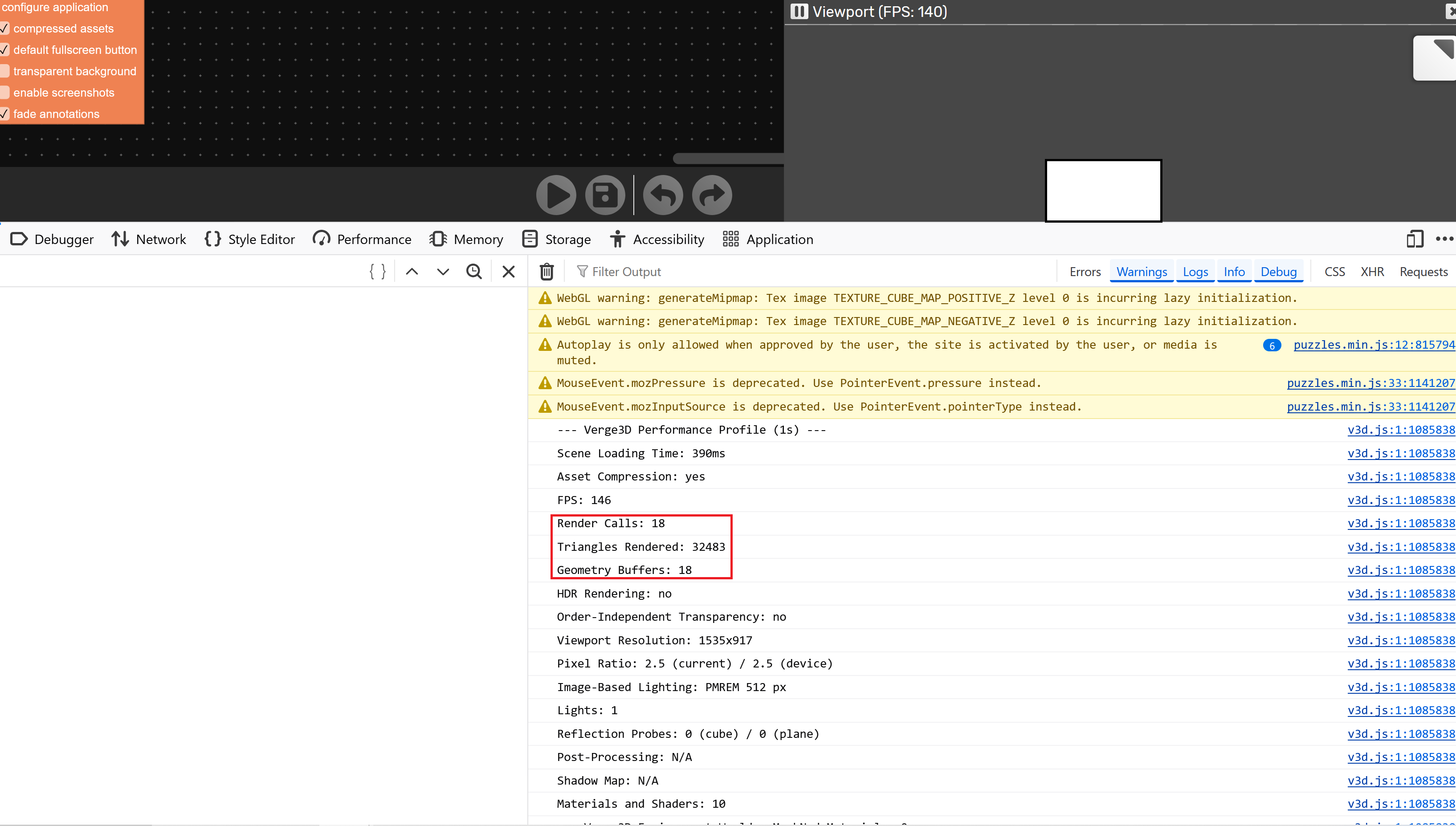

Higher Render call with compressed assets?
Home Forums General Questions Higher Render call with compressed assets?
  • #76230
    c4cc
    Without Compression:
    o46x1
    With Compression:
    o46x1
    Why does asset compression increase render call?
    #76240
    Hi, looks very unusual! Please verify the compressed and uncompressed scenes are actually the same.
    X | FB | LinkedIn
    #76241
    c4cc
    Yes, they are the same. Edit, after another test:
    With Asset Compression:
    o46x1
    Without Asset Compression:
    o46x1
    Also, why does asset compression increase screen loading time?
    edit:31.7.24 after vertice cleanup:
    o46x1
    7.8.24 update:
    https://ibb.co/LZyMVCs
    • This reply was modified 8 months, 1 week ago by c4cc.
    • This reply was modified 8 months ago by c4cc.
    • This reply was modified 7 months, 4 weeks ago by c4cc.
    #76244
    Hmm, this time render calls are the same. As for loading time this is quite normal, since Verge3D requires some time to unpack the compressed assets. This time will be fully compensated when you upload your app to a remote server. I mean there will be considerable time and traffic savings.
    X | FB | LinkedIn
    #76245
    c4cc
    Makes sense.
    Pardon my stupid question, but how does asset compression save time and traffic? Is it because when the assets are compressed, there is less amount of data to load?
    #76248
    Asset compression absolutely does not influence the amount of render calls.
    Yes.
