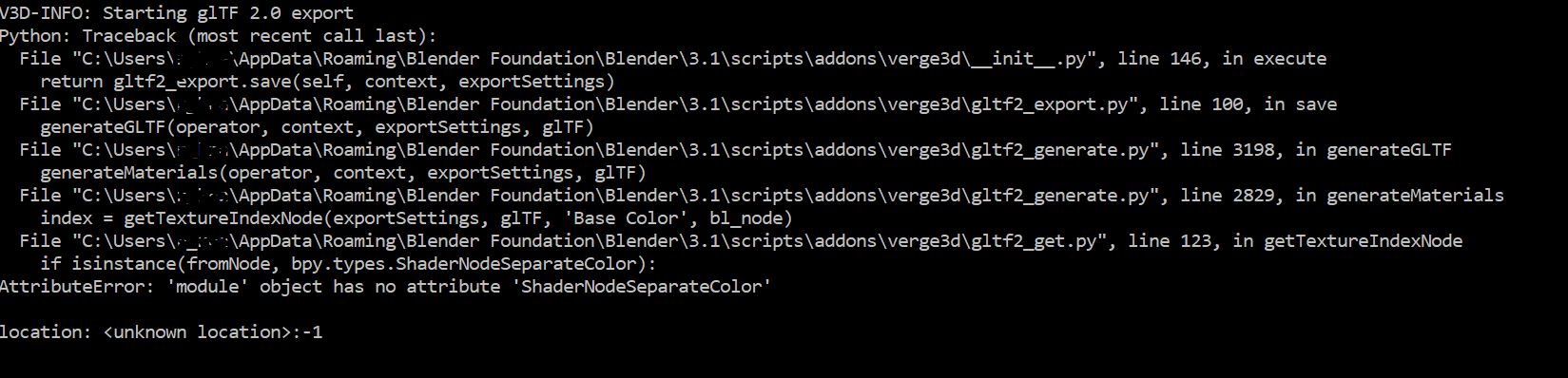

    Hi, when I export verge3D gltf these errors are shown.
    It is a fresh install of the farmer AR demo. No changes made.
    Any idea why this is happening?
    ps: I removed my username from the console text for privacy.

    Hi, what version of Verge3D you use? The issue like this was in some older versions of Verge3D.
    #59608
    vision
    Verge3D version 4.2.0 fresh install, also demo fresh install. I am using Blender 3.1
    #59616
    Thanks, we were able to reproduce this issue in older Blender. Going to fix ASAP. Meanwhile you can use Blender 3.3 which does not crash.
    #59617
    Blender 2.92 (the last supported in Win7) with the latest v3d addon also cannot export the last AR demo .blend. The farmer’s animation isn’t even working in this file ))) Only bones are moving.
    #59722
    vision
    thxs, it works with Blender 3.4
