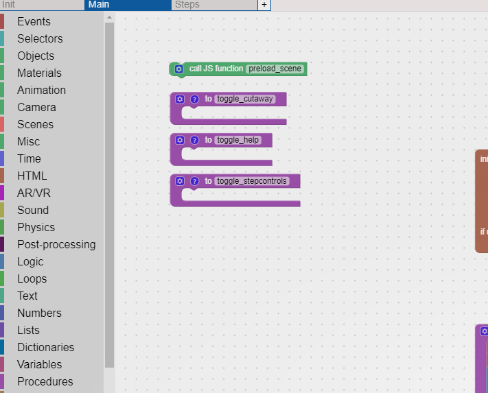

Gary, regarding you application: this feature is not directly available in puzzles, but you can use the callJSFunction puzzle to call it, if you register the corresponding function in the prepareExternalInterface() in your test_animationspeed.js file:
function prepareExternalInterface(app) { // register functions in the app.ExternalInterface to call them from Puzzles, e.g: // app.ExternalInterface.myJSFunction = function() { // console.log('Hello, World!'); // } app.ExternalInterface.preload_scene = function() { app.renderer.compile(app.scene, app.camera); } }
and call it somewhere before other puzzles:
I’ve added this preloading feature to your example and attached it to the post, it should work now without the fps drop.

2019-03-08 at 4:06 pm #12359gary
CustomerIvan, this is brilliant; thank you very much for your help! I’ve implemented this in my project and there’s a significant increase in fps. Now I can see where I might improve on that by optimizing a few models and textures. Thanks again!
