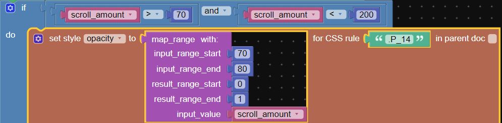

    thorsten moehle
    Just tried (still no luck)
    in the css i have the rule:
    .P_14 {
    opacity: 0;
    position: absolute;
    top: 400px;
    in verge:
    #36610
    thorsten moehle
    Hi There
    Could solve the problem
    CSS property opacity was the key bat had to use id’s for collection of several text boxes.
    Thank you guys for the fast responses!
