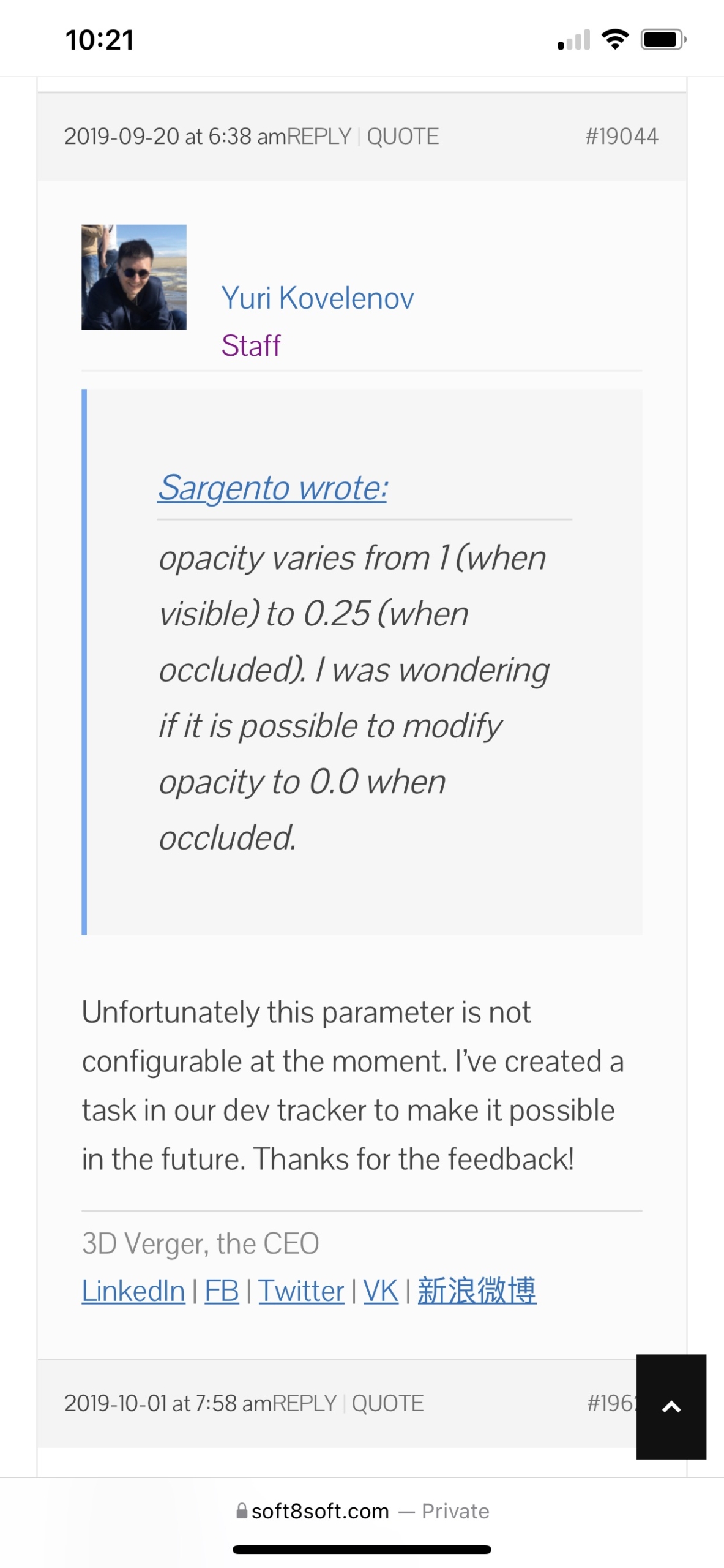

    I have the Fade Annotations box checked but I need them to completely disappear when they fade instead of still being slightly visible.
    How can I change that parameter to be zero instead of .25?
    I noticed in a post from a few years ago it was mentioned that this was going to be added.
    Please see attached picture.
    #48316
    you can modify the CSS property v3d-annotation-transparent – see this doc page for more info
    https://www.soft8soft.com/docs/manual/en/introduction/Personalizing-Verge3D-Apps.html#annotations
