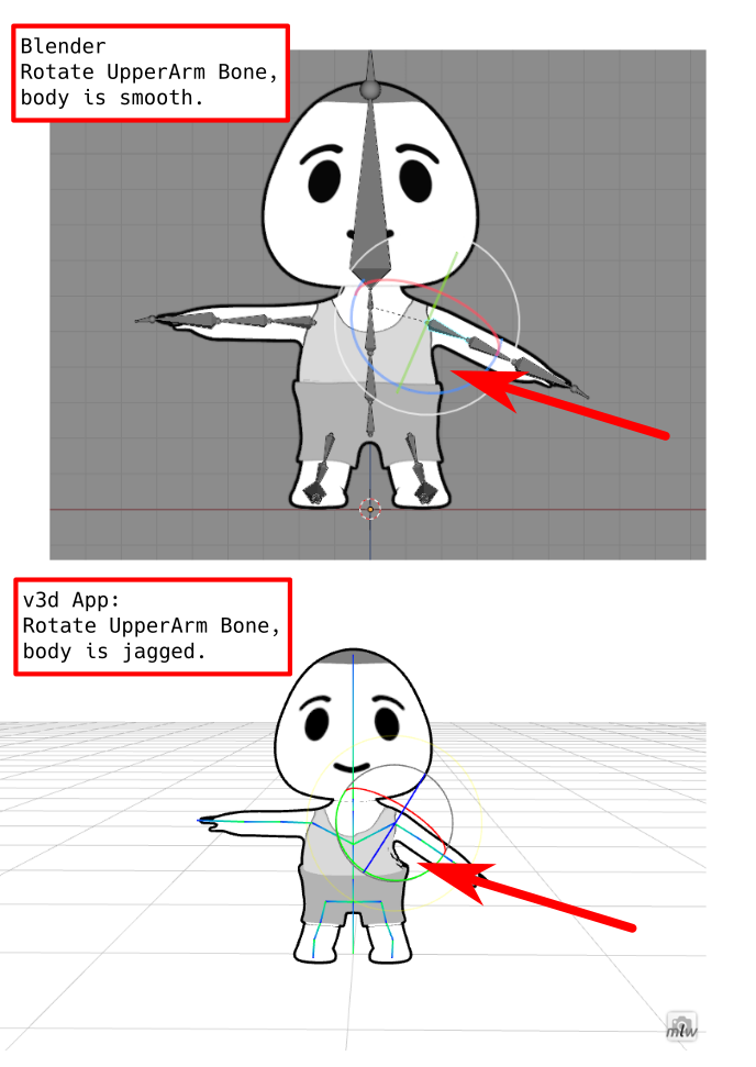

    I am creating Cartoon making tool. Models can be posed with using SkeletonHelper. However, when I rotate a shoulder bone, body is jagged. (Posing in Blender looks okay. Please see the attached.)
    I tried applying “Corrective modifier” in Blender, but it looks not working. Is there any way to get smooth?

    I have experienced similar problems with various version combinations of Blender and Verge3D.
    I haven’t validated in a while but I think Verge3d supports a maximum 4 weights per bone (4 most influential weights are selected, others are ignored).
    So you will have to check each bone.
    Alternatively you can bake the armature animation and discard the bones.

    Thank you for your quick reply. Actually I am using “Voxel Heat Diffuse Skinning” Blender add-on.
    I changed the addon setting to “Surface Heat Diffuse Skinning” and decreased the number of Influence Bones to 4.
    Now the character looks fine on my v3d app. Many thanks for your info.
