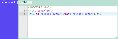

    I’m totally stuck trying to add some basic HTML using the exec HTML puzzle.
    Maybe I’m trying to do something that’s not possible but I assume it would.
    I’m trying to add a simple DIV with an SVG image like this:
      <div id="cirkel-icon" class="cirkel-icon"><img src="images/cirkel_icon.svg" loading="lazy" alt="">
        <div class="svg-button-wrapper"></div>
      </div>
    This works fine in my index.html but when typing this directly inside the exec HTML puzzle (to be able to create more of them for example) I get a console error.
    Uncaught SyntaxError: Unexpected token ‘<‘
    #75631
    This is not how it works. HTML code can’t be simply executed, it should be put as innerHTML property of some other element.
    For more info you might check out our tutorial series on HTML puzzles.
    #75641
    huib
    Hey thanks for the reply!
    Ah thanks for clearing that up, good to know it doesn’t work like that.
