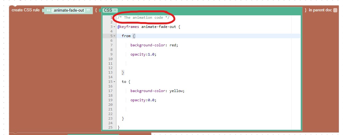

    I have been developing an app using the verge trial version. After installing the key yesterday, it worked fine but this morning when I started the computer the app only works in standalone in the puzzle window but does not work when embedded in another html(That was working yesterday even after installing the license)
    #51300
    leonard
    Found the problem. Just by adding a comment line in the CSS panel(see image), it caused an error in visual.logic.js
    #51302
    hi,
    not reproducing this issue using your setup. Perhaps some other puzzles in your app affect the outcome.
