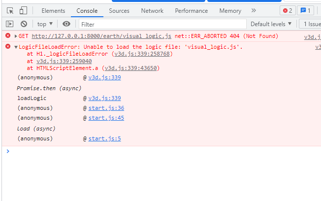

    I also try to run verge3D from Django, but for my part I can’t load visual_logic.js
    GET http://127.0.0.1:8000/earth/visual_logic.js net::ERR_ABORTED 404 (Not Found)
    Where is this file called exactly ? I thought it was in v3D.js but I can’t find a reference
    Is there a workaround ?
    #51146
    this file contains Puzzles logic for your app. It should reside in your app folder.

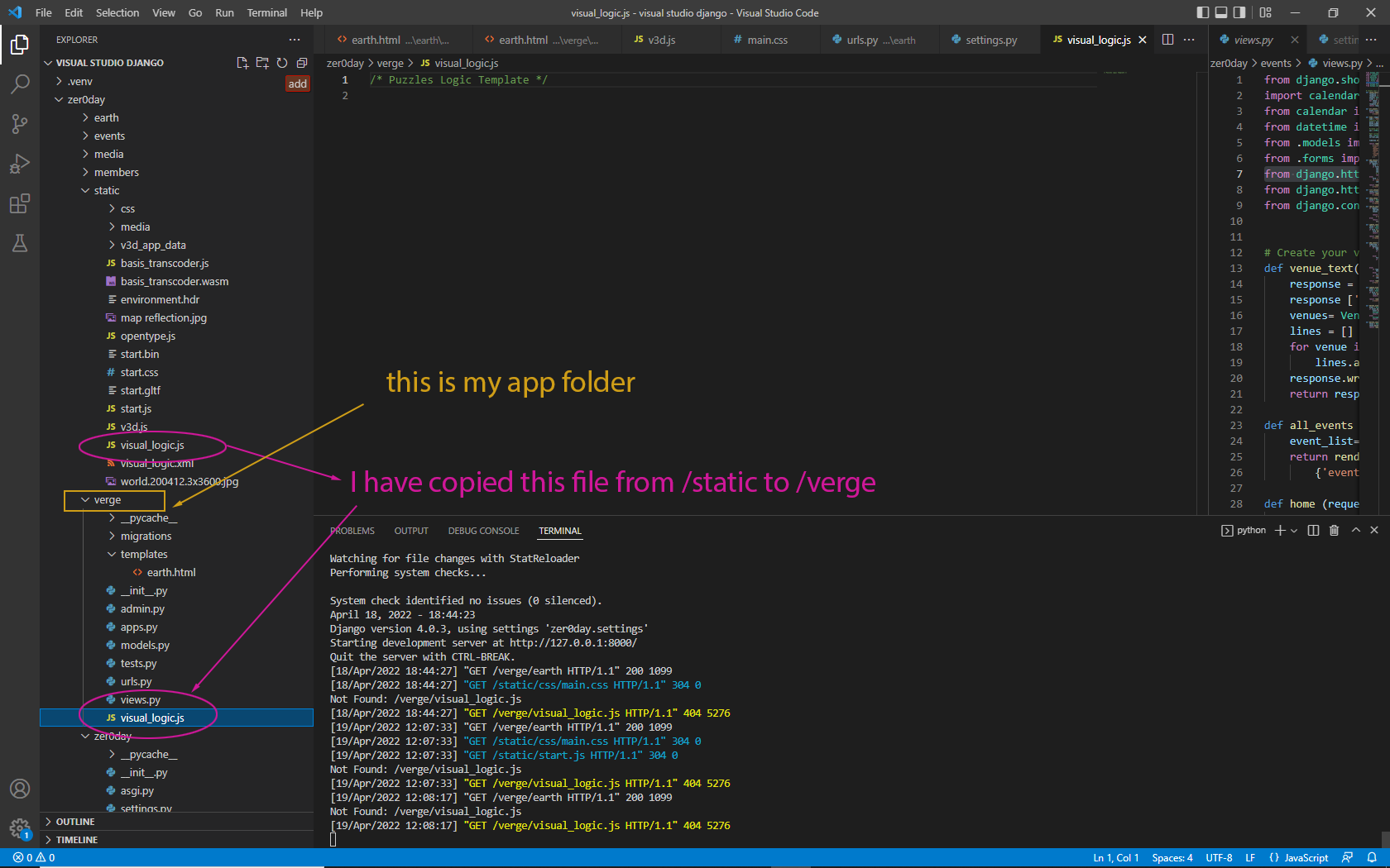

    #51153
    moiamy
    Hi Yuri.
    I have tried to copy visual_logic.js to my app folder with no success
