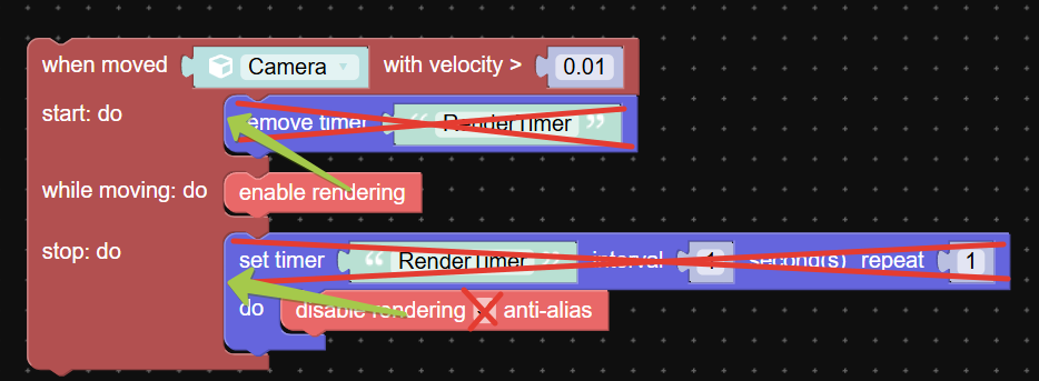

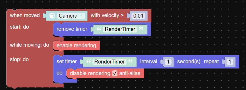

    Hi JasonOliver,
    Maybe something like this can work for you? :
    #79308
    but this puzzle set will react only to the scene camera rotation. and if you have animations or some other actions triggered by clicking or hovering this variant won’t do.
