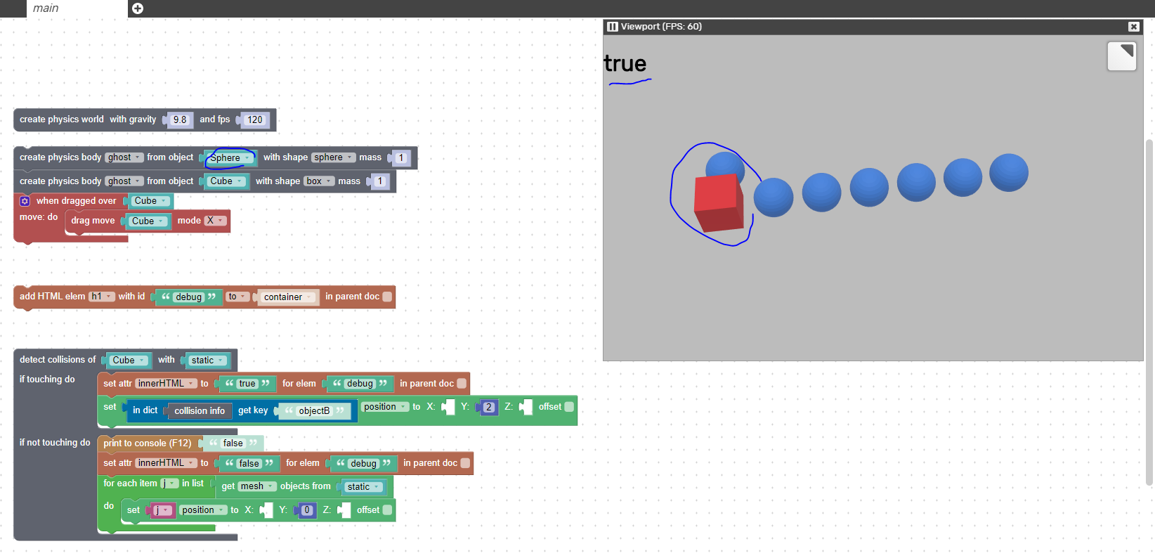

    I’m not sure if it is an issue about detect collisions puzzle. When the objectB is an object list or a group, the “if touching do” slot are always triggered, like a every frame puzzle. This makes the puzzles in the “if touching do” slot are not triggered. :-(

    I’ve checked this setup and it works as expected. Make sure, that the source object is not included in the list/group, also keep in mind, that detect colision works on a continuos basis i.e detecting collision state or a missing collision state each frame.

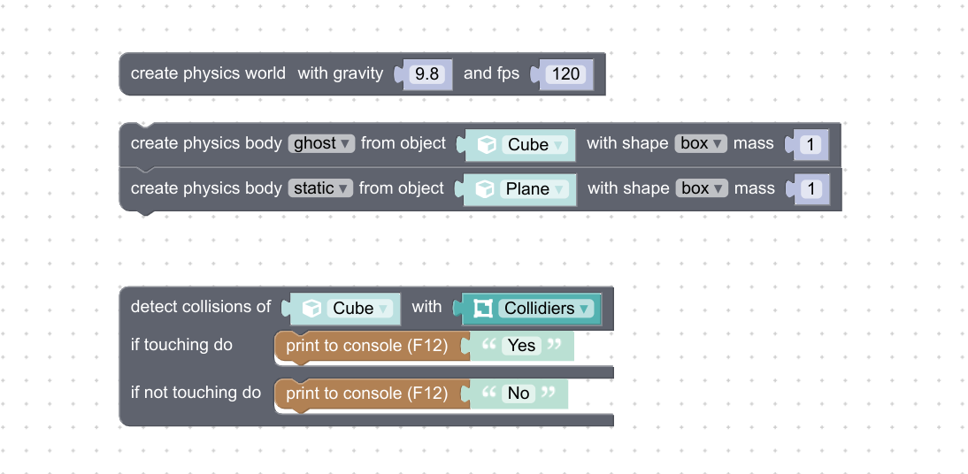

    zjbcool
    I made a project to show the issue. See the attachment.

    I Think the issue is with collection, i don’t think that collection being supported yet, i jsut made one object at time and it worked.

    Thanks for the example! We did manage to find the root of the issue. Going to fix it in the upcoming pre-release.
    #34468
    Fixed!
