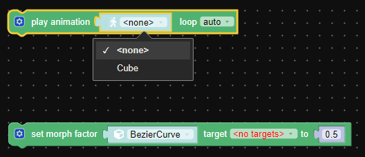

    In blender, I have a curve with shape keys and I have animated the value of the shape keys.
    When I export my glTF and load it with Verge3D, the shape keys don’t exist.
    The object doesn’t show up as having any animations (doesn’t appear in selection list of the “play animation” puzzle.
    The object shows “no targets” when I select it in the “set morph factor” puzzle.
    I tried animating the shape keys of a mesh instead of a curve in the same project, and those shape keys come through just fine, so it seems to be an issue specifically with curves.

    Blender curve support is highly desired a feature in Verge3D but its only sparingly supported: Follow Path curves as an example.
    Shape keys in Verge3d only work on meshes.
