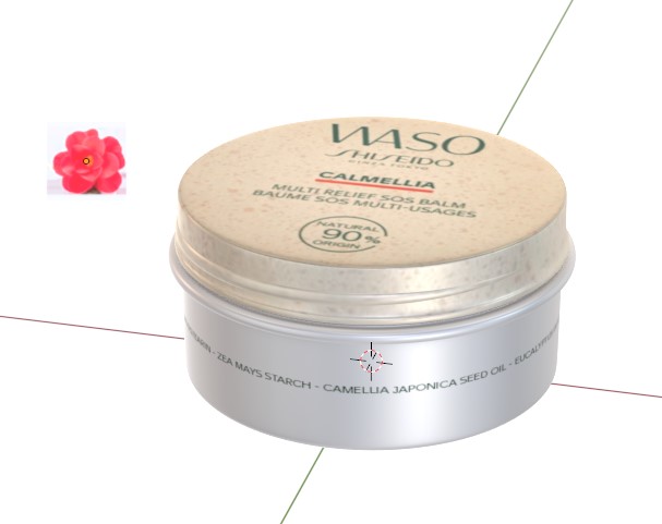

    So I created a plane object and put an image on it.
    Now I want the plane to always face the camera.

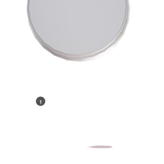

    In blender it works just fine (img 1), but if I export it I just can see the object from a weird angle (img 2). I used the standard properties (img 3) for this but also tried other settings.

    Remove the constraint, rotate the plane around X axis by 90°, apply rotation (Ctrl+A), add the constraint back.
    That’s because of different coordinate systems: Z-Up-Right in Blender and Y-Up-Right in Verge3D/THREE.js
