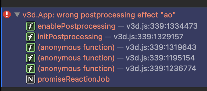

    Hi team
    I seem to have broken dynamic AO somehow. I did update to version 4 a couple of hours ago but I had a feeling the problem may have already been present before updating.
    https://content.une.edu.au/2022/3dp_dinosaur/
    Any advice how to hunt down what might be causing the console error?
    Love the new update – especially puzzle replace on compressed textures was great for me :)

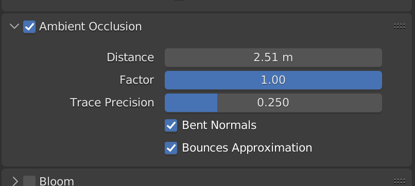

    raphroberts
    Hi Alexander, thank you for your quick answer. Unfortunately though I am not using any AO puzzle. Perhaps I need to reinstall verge3d? I am using Blender 3.1.2 with AO as in the attached image.

    #53136
    Fixed this issue! Gonna make a minor Verge3D update soon. Thanks for the heads up!
