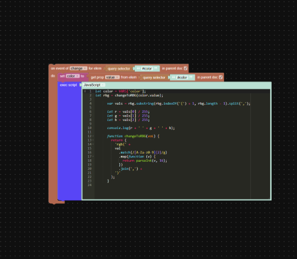

    For several days we have been trying to link the color picker RGB value on a WordPress page to the color of my T-Shirt, which we made in Blender. We need the person who visits the page to be able to choose the color of the shirt using the color picker themselves. But we can’t find a way to do this.
    This is my color picker code in WordPress:
    <input type=”color” id=”color”>
    And this is the error, which we see in the console.
    Uncaught SecurityError: Failed to read a named property ‘document’ from ‘Window’: Blocked a frame with origin “https://cdn.soft8soft.com&#8221; from accessing a cross-origin frame.
    at Object.getElements (visual_logic.js:135:24)
    at eventHTMLElem (visual_logic.js:207:23)
    at PL.init (visual_logic.js:218:1)
    at Base T-shirt.js:53:20
    at v3d.js:1:1390039
    We use this structure right now (know that this is not a full structure for color picker action, but first of all needed to understand if we could read the external variable from the site, not from the Verge 3D window).
