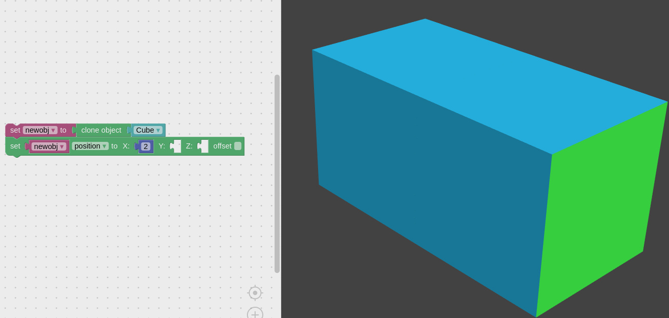

    #7956
    You can use a variable to store a new object name and use it for further operations.

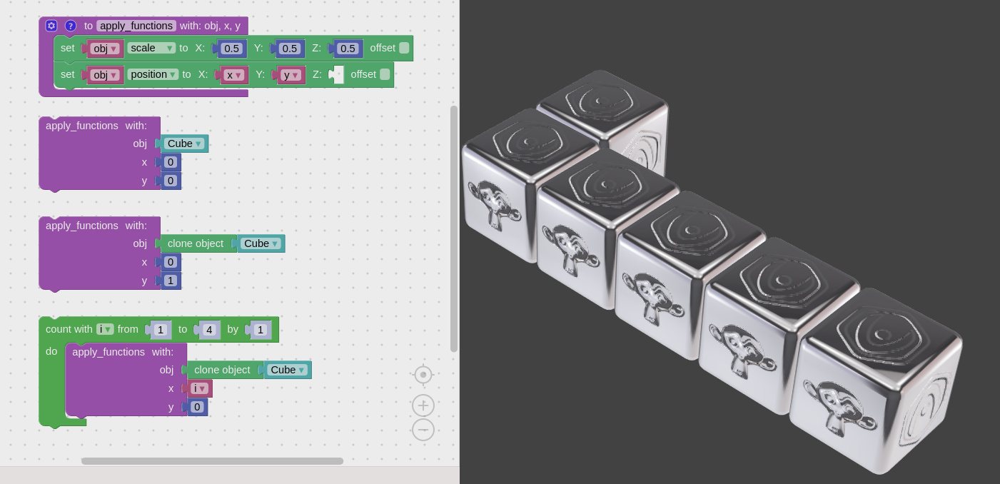

    #8137
    Answering here to the question how to apply the same functions to cloned objects. You can create a procedure that takes an object as parameter (and also some other parameters such as coordinates) and apply this procedure to cloned objects. This can be done individually or in bulk.
    #8139
    Here is the logic file:
