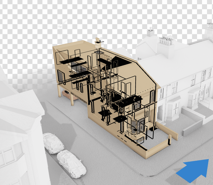

    Hi all,
    I’m currently having this issue when looking through a clipping plane where the geometry behind the clipping plane is showing though even when not being clipped – see attached image.
    Is this an issue of having geometry that isn’t solid/closed or is there an option I can use to get rid of this? It seems to occur when you are looking at a backface through the clipping plane.
    Any help would be appreciated.

    Please try to disable “Filled Cross-Section” and increase “Cross-Section Size” value.
