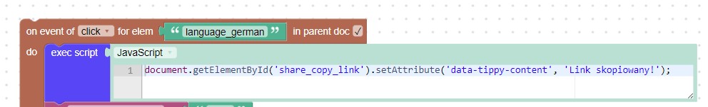

    Hi! I work on adding the language translation system for my configurator, and I only have one problem with it. I use tooltips by Tippy.js, and I need to set the translation for the text that appears in the tooltip. In Webflow, I’m setting an attribute with the name “data-tippy-content” and value, let’s say “Link copied” for a “Share” button. I want to change the value to “Link skopiowany!”. How can I change the value on click in Verge3D? I’ve been trying Javascript like the below but with no luck:
    `document.getElementById(‘share_copy_link’).setAttribute(‘data-tippy-content’, ‘Link skopiowany!’);

    Perhaps they offer some API in Tippy.js which you could call. Alternatively, you could try to replace the contents of actual HTML elements generated by this framework (with innerHTML), although this would be not a very reliable method.
