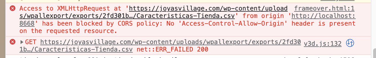

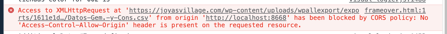

    I have an app that reads a bunch of data from various CSV files. It works fine when the files are in the same directory as the app, but not when they are hosted on my clients server. I keep getting this error shown in the attachment. They want to keep them on their server so they can easily update them. What are we doing wrong here?

    This is a cross-origin issue – the files must always be served from the same domain. So the .csv files must be present in the app folder on the server, so that the app can read them.

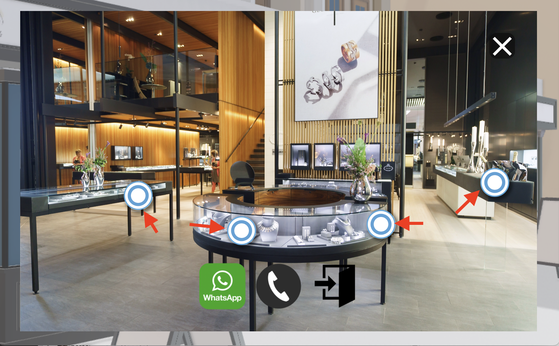

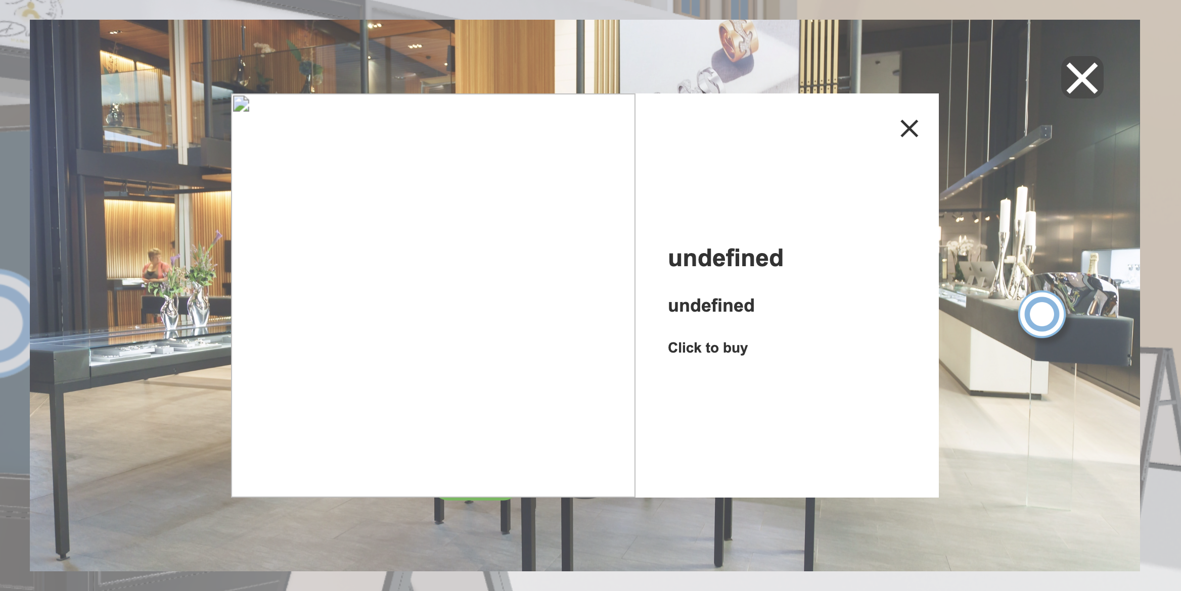

    I should have been more specific – when you click on one of the circle icons it should bring up an image of a store with some clickable icons in it, and those icons should bring up products – the product information is what is missing.
