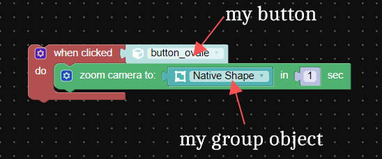

    I used the “zoom camera TO ” puzzle to zoom to an object.
    My prblem is that the camera, after moving to the desired posision, come back to another old position. any idea?
    Have i to put some other puzzles in the “when finished slot”?

    very simple. my cam is in position, let’s say A, and after pressing the button , it moves slownlo to zoom the ” group “. after the lerp, it doesn’t stop at that positin but the position A.
    EDIT: NB! it works only if my “min/max distance in 3dsmax are larger.
    SO..yes it works but we need to be aware of this.
    MR
    #50363
    Yes, if zoon target out of camera limits zoom may not work properly.
