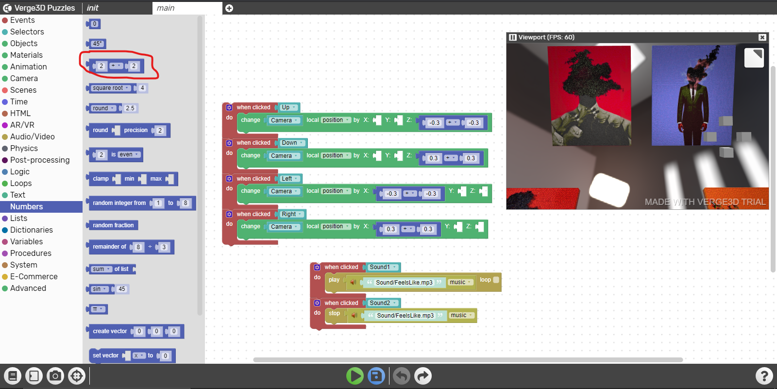

    Thanks all for being here creating this amazing application! – I’ve been having loads of fun + healthy frustrations trying to get my app to work. Right now I’m stuck and would like some assistance. I’ve gotten to parenting the camera to some objects in front of it for mobile controls, but when I use change-local-transform I’m only able to control the rotation, unfortunately I cant seem to get position to do anything, what are my options? I’ve attached a screenshot of the .js & of course a link to my app http://www.mosojones.com/atp

    So after mulling around I found that one of the number puzzles helps move the camera with the position puzzle attached “Return the Sum of Two numbers” I’ve attached a screen shot and an updated app if anyone needs help figuring this out without html.

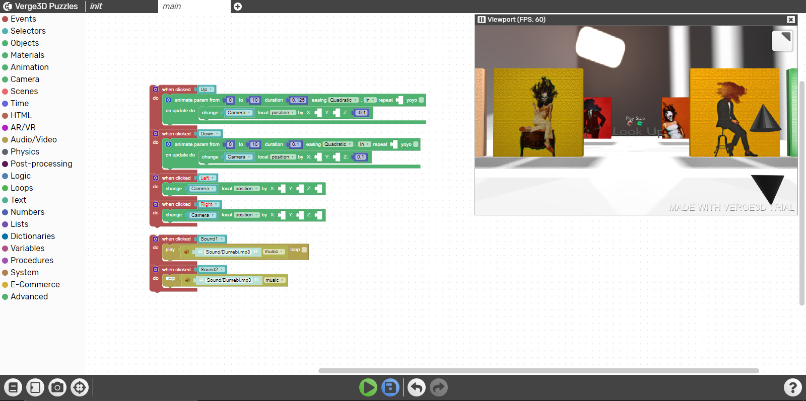

    sorry for slow response. For smoother transitions you can use the puzzle animate param.
    https://www.soft8soft.com/docs/manual/en/puzzles/Animation.html#animate_param

    Thank you! Here is the new screenshot of the puzzle that runs the controls!
