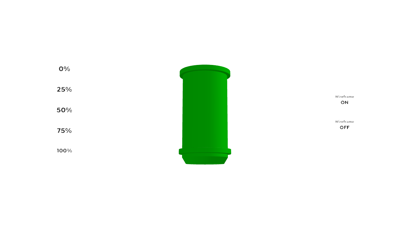

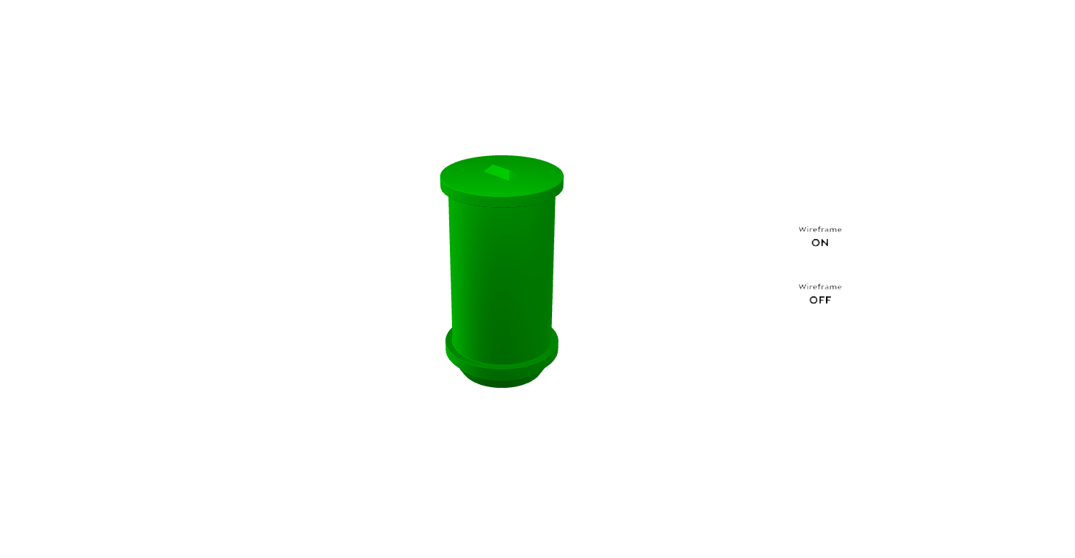

    I made this project following Verge3Ds youtube with the pocket knife.
    I have made 7 buttons, 5 on the left side and 2 on the right (see image)
    The button works as intended but when i publish it and open the link, the buttons on the left are not visible (see image 2), they are still clickable and does its function, but not visible…
    I did everything the same in 3Ds max…
    Please help.

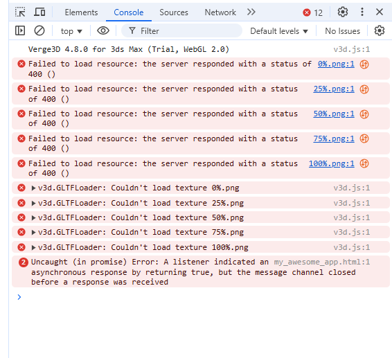

    press F12 and show what you see in the console log.
    #80115
    stomann45
    This is the errors in consol, i dont understand why i cant load the buttons on the right but not on the left…
    #80119
    the answer is on your screenshot. rename your textures properly (without %)…
    #80120
    stomann45
    Yes i realised that too, thank you!!
