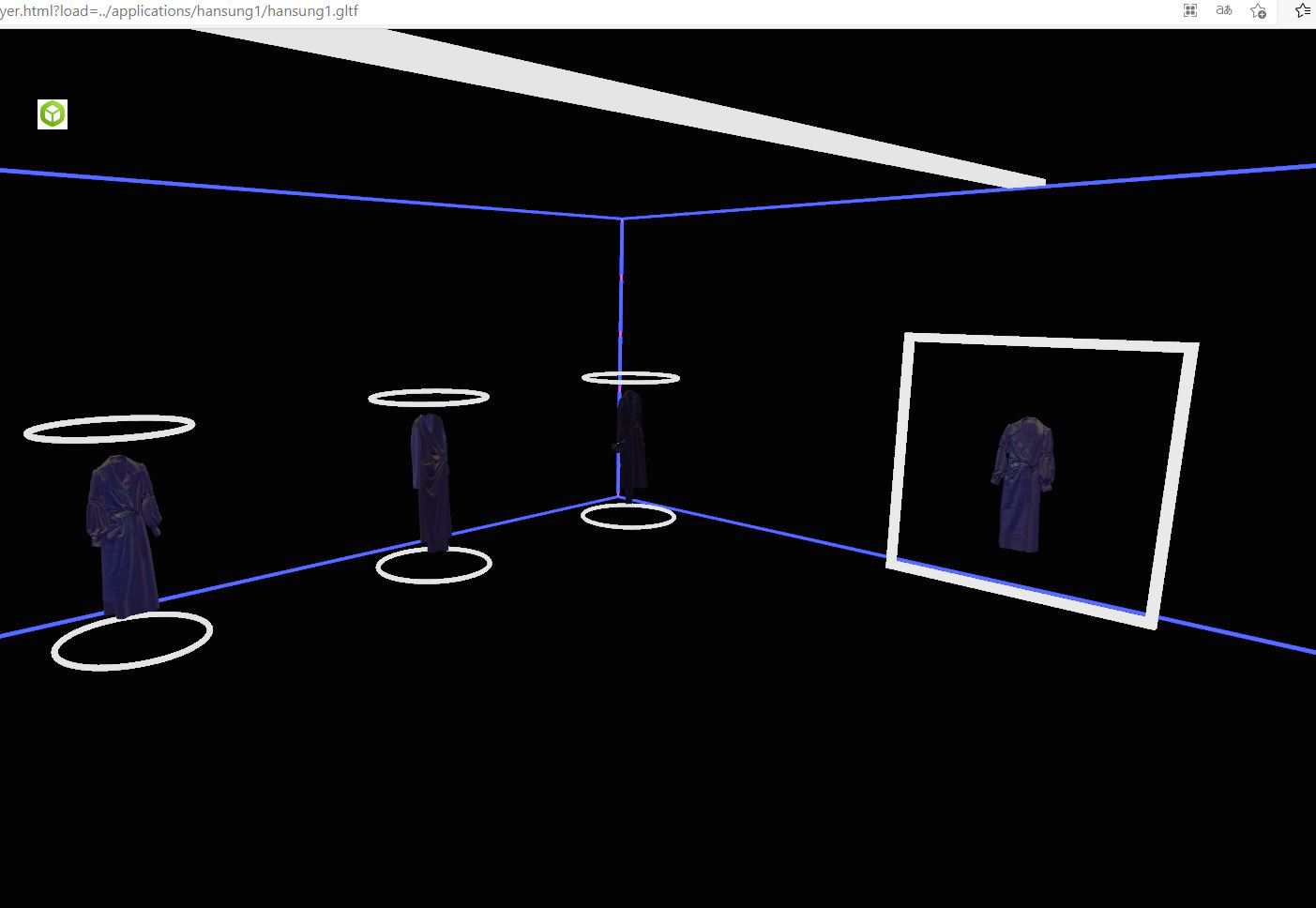

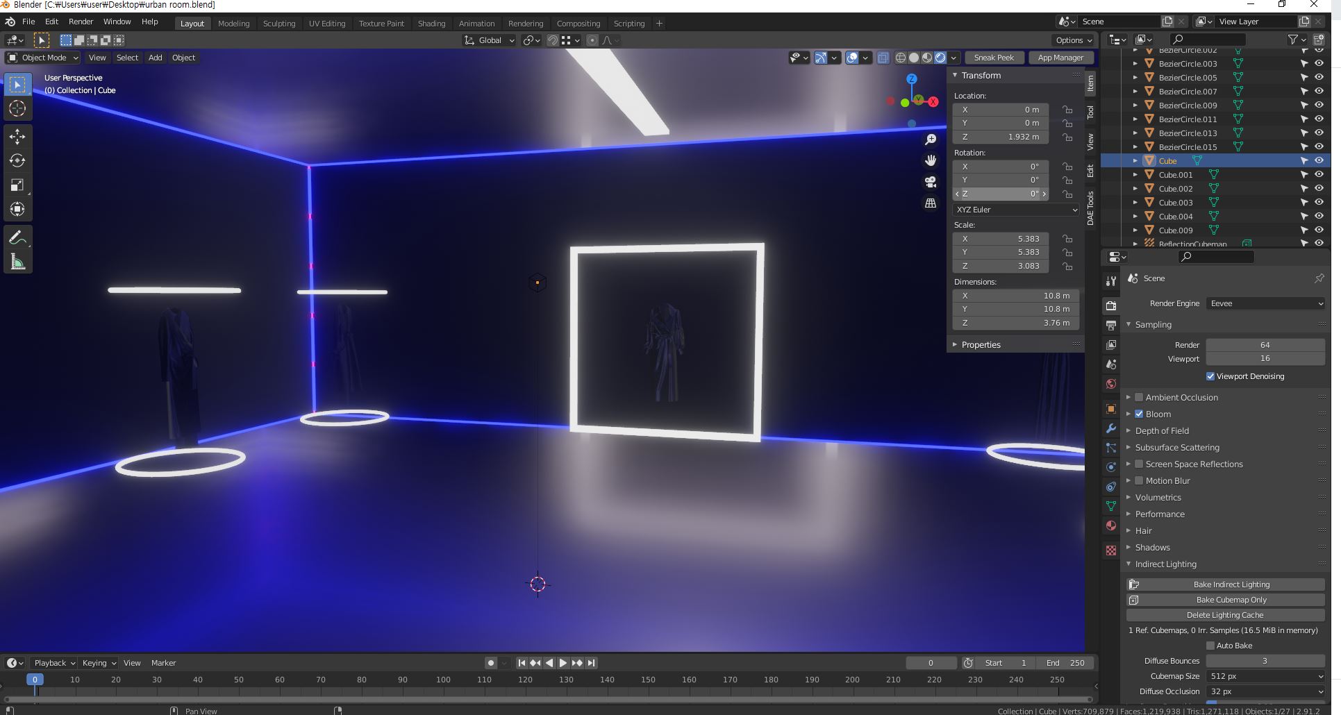

    When you open it in the scene, a screen that has been baked with a blender appears to some extent. But when I open it in run app mode, it doesn’t bake at all. Do you know what’s wrong with this?

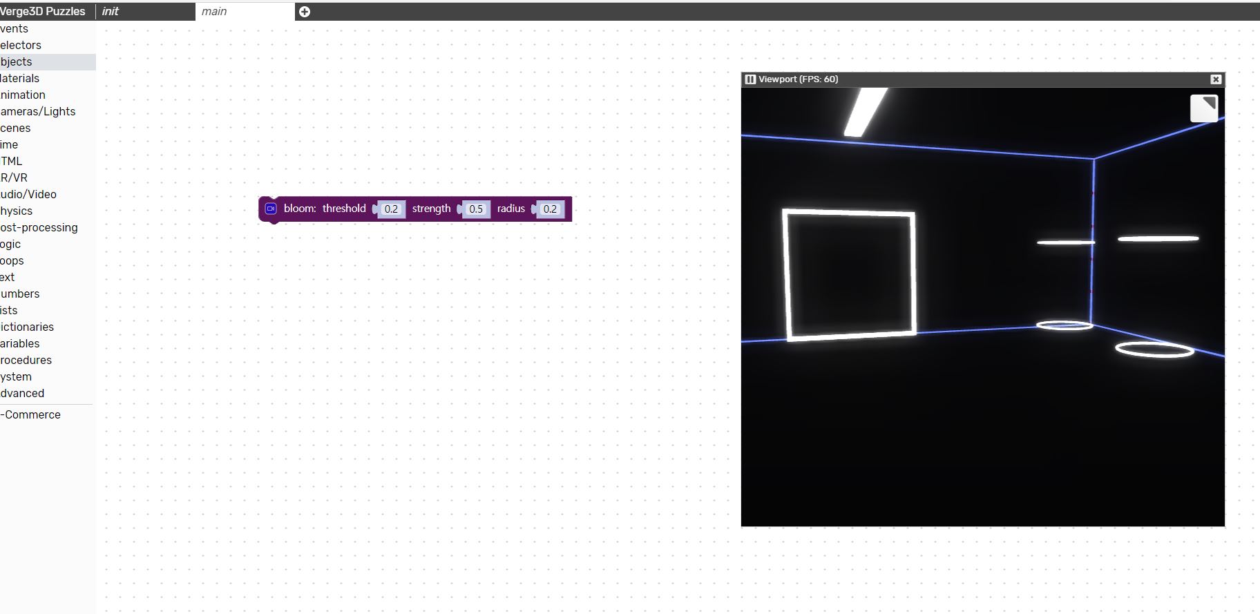

    There are a few things you can do to help you achieve the look you are trying to do in Blender within Verge3D.
    1. You will need to turn off Bloom and rebake your cubemaps as Blender’s bloom is not supported in Verge3D. Your scene will import and resemble the Blenders Render View.

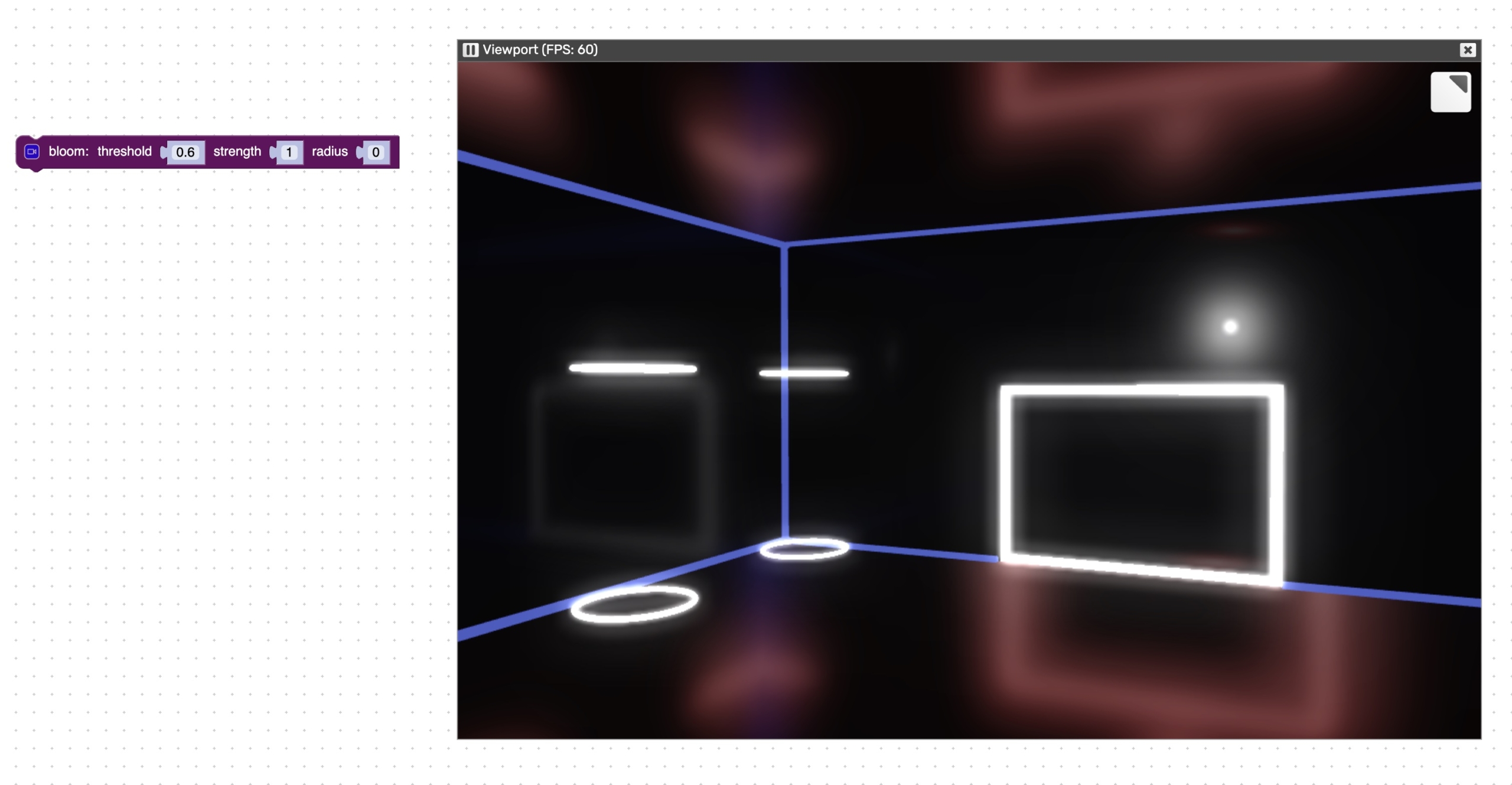

    2. Adjust your Verge3d bloom puzzle settings.
    My settings were threshold of 0.6
    strength 1
    radius 0
    3. you can greatly affect Bloom by your material properties if you can’t get the control you want from the bloom puzzle itself.
