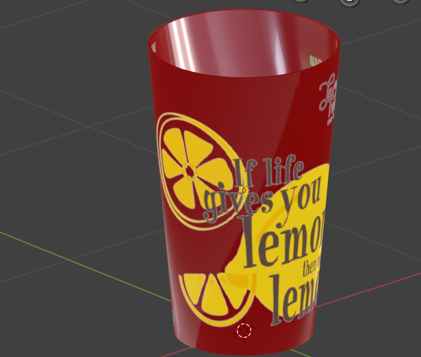

    A long time ago, i make a working scene with a cup and logo on it.
    The backface of the logo was visible.
    I can’t remember how to make it, i want the logo to be visible when looking the other side of the object or by the interior
    Any help appreciated.

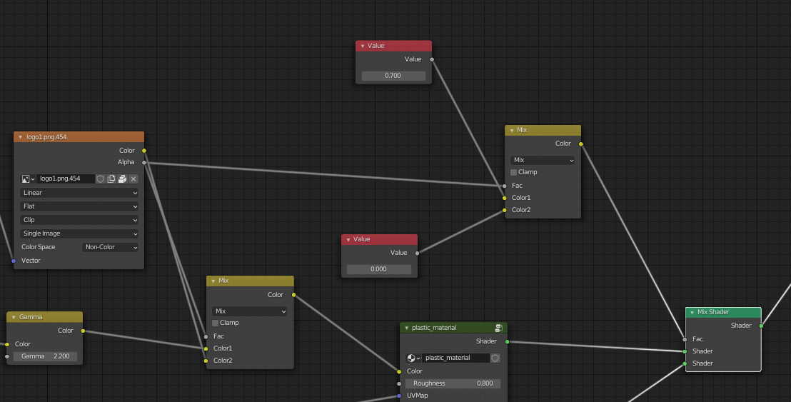

    #41653
    marshallus
    i’m sorry cant make it work, it’s on/off, i want to control the opacity %
    thanks
    #41666
    Can you share the screenshot of what you’ve get in material.
    #41670
    marshallus
    of course
    #41674
    This must work, can you share new setup again?

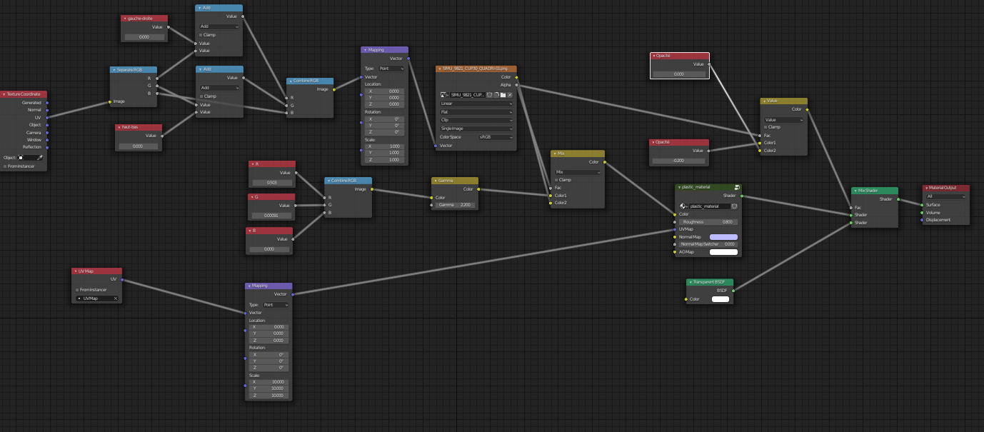

    #41675
    marshallus
    thanks, here it is
    #41775
    marshallus
    just try lot of nodes, i’m not smart enough to find out

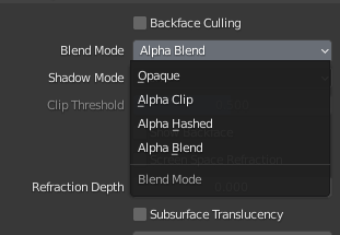

    #41777
    You need to set Alpha Blend mode for material not alpha clip.
    #41779
    marshallus
    sorry, not working :/
    #41794
    What you mean under transparency then?
