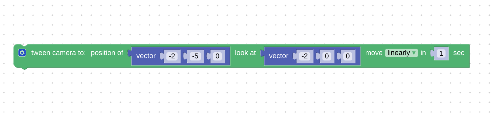

    If you move your camera along some plane, you might calculate position/look inputs by hand (by passing vectors to the corresponding inputs):

    I was already looking that way with the Verge3D API, to get the right final position vector…
    here is the procedure I wrote to get this vector, that I can use in the tween camera puzzle. Took me quite a while to get the differences between the Vector3 and the simple array that this puzzle takes as an input!
    Anyway it works now.
