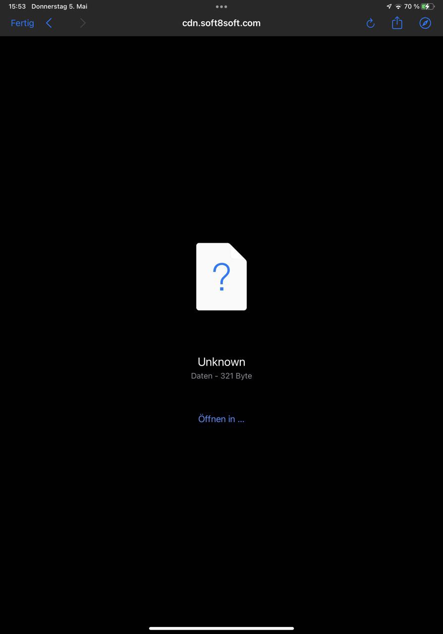

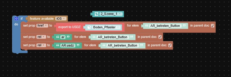

    I’m trying to get my scene ready for AR under iOs. I studied the AR Example Project and “copied” the puzzles as show in the screenshot.
    But when I click my button, safari is asking me if I want to download a file named Unknown without a file-type-ending.
    What am I doing wrong?

    #51786
    hi,
    there a “typo” in your puzzles – the third puzzle must be ‘download’ not ‘rel’, which is duplicated.
    Yes you can use a scene rather than a single object as input to this puzzle.

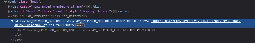

    #51830
    Hi Yuri,
    thanks, that explains a lot! :good:
    But now Safari asks me if I want to download the file: AR.usdz.xml and really just downloads it. And it can’t be opened because iOs thinks that it is an xml file and not a usdz file.
    I am using Verge4.0 pre4 with compressed textures. Maybe this is a bug in the current pre4?
