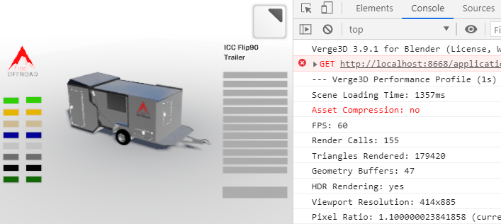

    too many polygons for such simple model… and there’s no need to set native screenscale. for example, for iPhone12 it will be 3px ))) too heavy to render…
    #52055

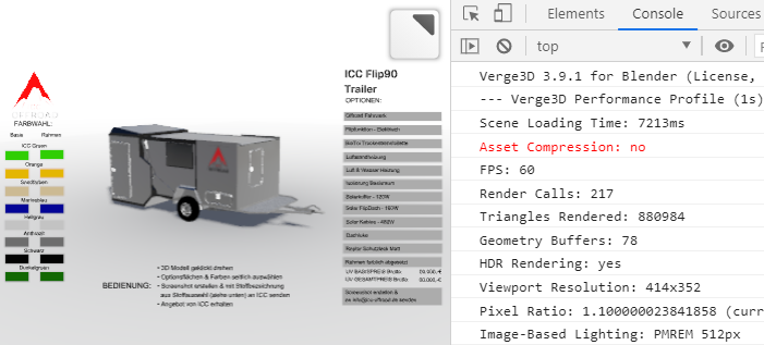

    with text :scratch: takes too much memory (~800-900mb) and crashes even on iPhone12…
    without text :) runs on any phone, takes about 100mb of memory…
    why??? why do you use letters-meshes in the interface? )))

    “why??? why do you use letters-meshes in the interface? )))”
    The interface is completely done within Blender.
    Hence I did use letter meshes.
    Can you suggest please with what kind of mesh or other object I can replace those elements within Blender while maintaining the same looks?
    Thanks for your suggestion.
    #56561
    Just create the same interface in HTML. Or, at least, use primitive planes with textures. You can create one texture with all letterings…
