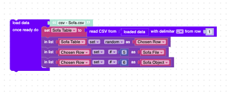

    I’m trying to get file names from a csv file. In a csv file I have the scene file and the object name. I want to randomly choose one row and get the scene file name (.gltf) and the object name. When I input the fields manually I can append the files no problem. But when I attempt to get the data from a csv file using variables it doesn’t work. Probably because I am doing it wrong.
    How can I make it work?
    #55053
    First, print to the browser console the variable Sofa Table to see what you’ve imported. Just print to the console the results af your actions to see what’s wrong…

    Thank you!! I made it work if I just want to import a random row.

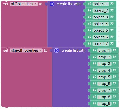

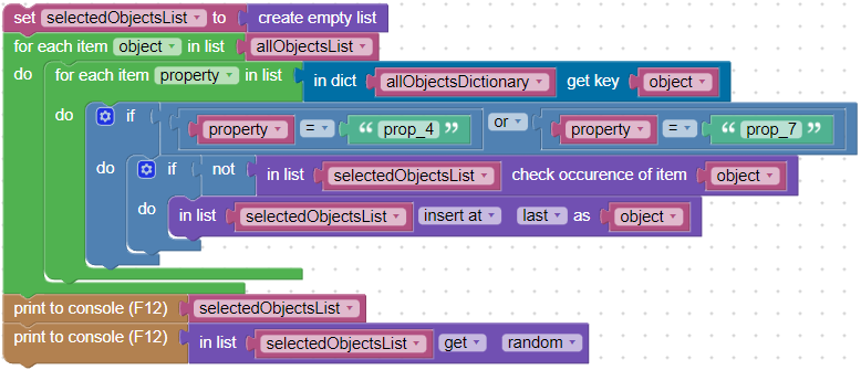

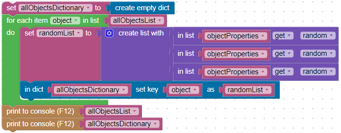

    Something like that )))
    Preparing a list of objects with different sets of properties
    Searching objects with predefined properties (one or more)
